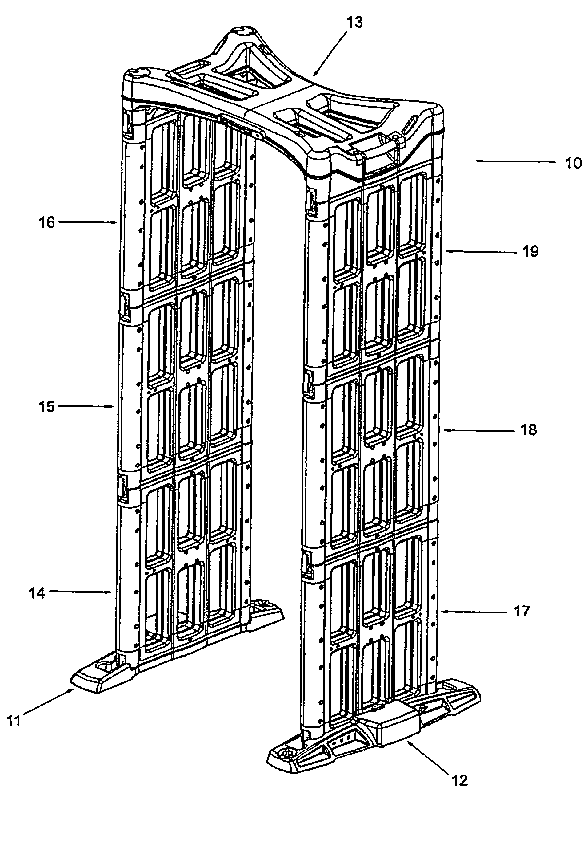

    How is outside detection prevention and shielding accomplished in a commercial machine(walk-thru)?? Aren't there technical drawings of such machines available?
    That would be intersting. Seems to me there is always a perimeter of empty space around such machines(no-go areas). With a properly designed coil array(pot core) and minimal exclusion materials( aliminum backing), it would be able to focus the thing for minimal side leakage.
      have a look at this sort of arrangement.

                It might help focus the magnetic lines of flux more towards the intended area, and away from the sides, that is the point. Perhaps even a double ring with a toroidal coil to repel the flux of the main coil. All just conceptual ideas, of course, none of which may work.
                I tend to visualize a physical arrangement which is practical and feasable in construction, then try to determine what the geometry says about the electromagnetic characteristics. Many solutions sometimes tend to have a geometric elegance to it. Geometry and physics are like hand and glove.
                  How about a second coil which is slightly larger in diameter than the main coil, connected to a weaker synchronised TX pulse, but of opposite polarity. The second field generated repels the main field away from the edges and focuses the main coil field more to the intended area. Maybe even winding the second coil on a toroid core may enhance the effect. The second coil would be encased in a ferrite ring except for the portion facing the first coil.
                    Still trying to figure out what a " unidirectional anti-magnetic structure" is all about Maybe my idea fits the bill
