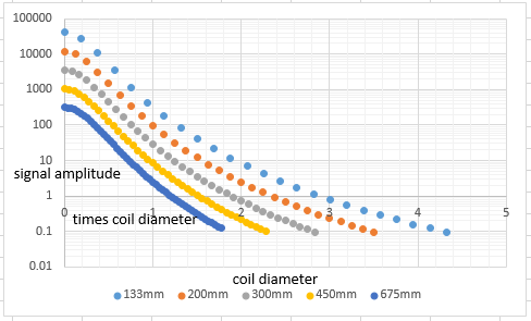

      Is anywhere here handy formula for approximate calculation of signal attenuation with relation to coil diameter (mono coil), target distance and target diameter
      I just want to understand a little bit this process, i exactly know what signal, at first integrator output, decaying not by linear law.

          Cannot help with that one, however Eric did publish a graph, which requires carefull study to understand it, but its sort of in the realm of describing something close to what you are asking
            https://www.geotech1.com/forums/show...908#post241908
            A chart that compares detection distance vs coil diameter using the same target. Targets move the curves up and down depending on size, slope stays the same. Assumes noise stays the same, I get noise proportional to coil diameter if inductance stays the same.
              Thanks again 6666 and green, i still remember that chart, will try to learn.
              I think what if measure maximum distance to target not by santimeters, inches, etc. but by relation to coil diameter, say distance 3coil diameters, 2coil diameters, 0.5coil diameters, if take care for coil and target proportion. Is it will be more practical? I may be wrong).

                The coil diameters increase by 1.5 with the chart.
                Wasn't thinking. You are suggesting X axis should be coil diameter maybe 3 diameters full scale? Have to think about that.

                  Think same data charted vs coil diameter
                    Thank green, i just thought like a beginner. Now i have doubts i feel i need to study the theory.
