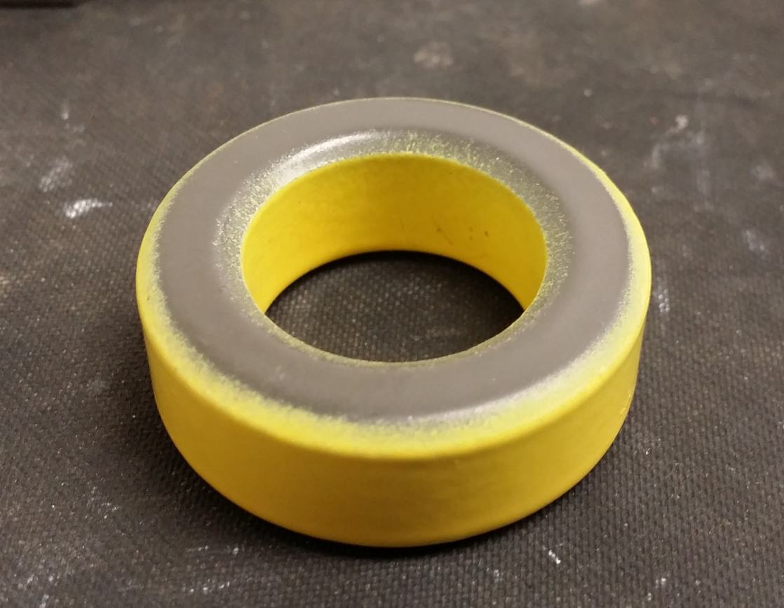

    I thought I'd try to find out what material Minelab used for the "yellow doughnut" since this material provides the ground balance ferrite calibration point it might also be good stuff to use as a solder/component mask, so long as it does work in stealth mode.
    I found a good freeware app to use. You just wind a dozen or so tight turns on your toroid, measure and input the inductance along with dimensions and the program calculates the permeability ui and AL figures and from there you can identify the likely ferrite material.
    If only they would put their makers mark on these cores, then you could rely on colour codes.

            With 10 turns .4mm around the yellow ferrite ring which I identified the old way through colours at 10kHZ is about 1.66 uH. (DE-5000 LCR meter)
            The ring I bought hoping it matched minelabs, was only matched by colour and tables, would be interesting to compare with another that has been supplied by minelab if anybody has a real one,
            and yes that's how we spell colour in Australia.
            The calc thats linked in the video gives my yellow ring an Initial Permeability of 13
            so closest is type 15 material NiZn

                Hi 6666 your material might be good enough.
                If I tight wind I get 10uH for 22 turns and loose wind gives 5.3uH which equates with an ui of 17.7 to 8.8 respectively.
                The closest in the Amidon range is T130-6 (6 material nominal ui= 8 which matches the colour scheme also (yellow/clear)
                Using another LCR meter that I don't trust as much, puts it in the T130-3 (3 material nominal ui= 35) colour plain grey.
                A few makers use the yellow/clear for the type 6 mix, so we might be close enough to assume that this is the ground susceptibility benchmark Minelab use.

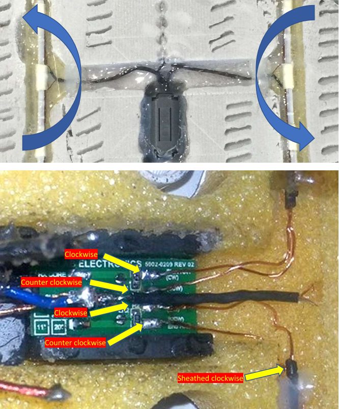

                        If my assumption is correct and the Russians did adhere fairly closely to the main construction methods when reverse engineering the GPZ coil, it appears the RX coils are adding and not opposing.
                        It looks like in both the original and the X-coil the wind has a "clockwise" sleeve to identify which wire is which. Thus the junction coil connections can be surmised from this
                        On the junction pcb, the clockwise wire of the first coil (assumed sheathed) goes to the cable core and the counter-clockwise end joins to the clockwise end of the second coil (definitely sheathed) and its counter-clockwise end goes to the cable screen.
                        The double near surface signal with small items is thus likely due to the target inducing a signal as it passes either coil edge, and not from a centre null that would occur with an opposing topology.

                          Interesting you are suggesting Rx coil are adding not opposing. When I made one, adding is the only thing that made sense. Wondered if I missed something. You are the first to suggest Rx is adding that I've seen.
                            Yes I saw your experiments, very informative, thank you very much for sharing those.
                            From your opposing demonstration I just couldn't reconcile that massive null to what I experience with the machine, it didn't spatially recover like i understand ZED to behave.
                            I felt it must be an adding arrangement, and looking at the foregoing I think it is probable, I will find out once I start laying it out.
                            Remember too, this is not your usual detector, without a super D it wouldn't leave the bench.
                            I could still be wrong of course, time will tell.
                              Yes its all yellow
                                Yes its all yellow
                                6666 what makes me think the Minelab one is the same as the Amidon one, is that the actual Minelab one has a clear side, and the Amidon Type 6 is also yellow with a clear side.
                                T130 is the size and it matches in that respect also, so I'm pretty convinced that an Amidon T130-6 will get you a very close if not a replicate toroid.
                                Having said that, your toroid may be another manufacturers offering of the same part.
