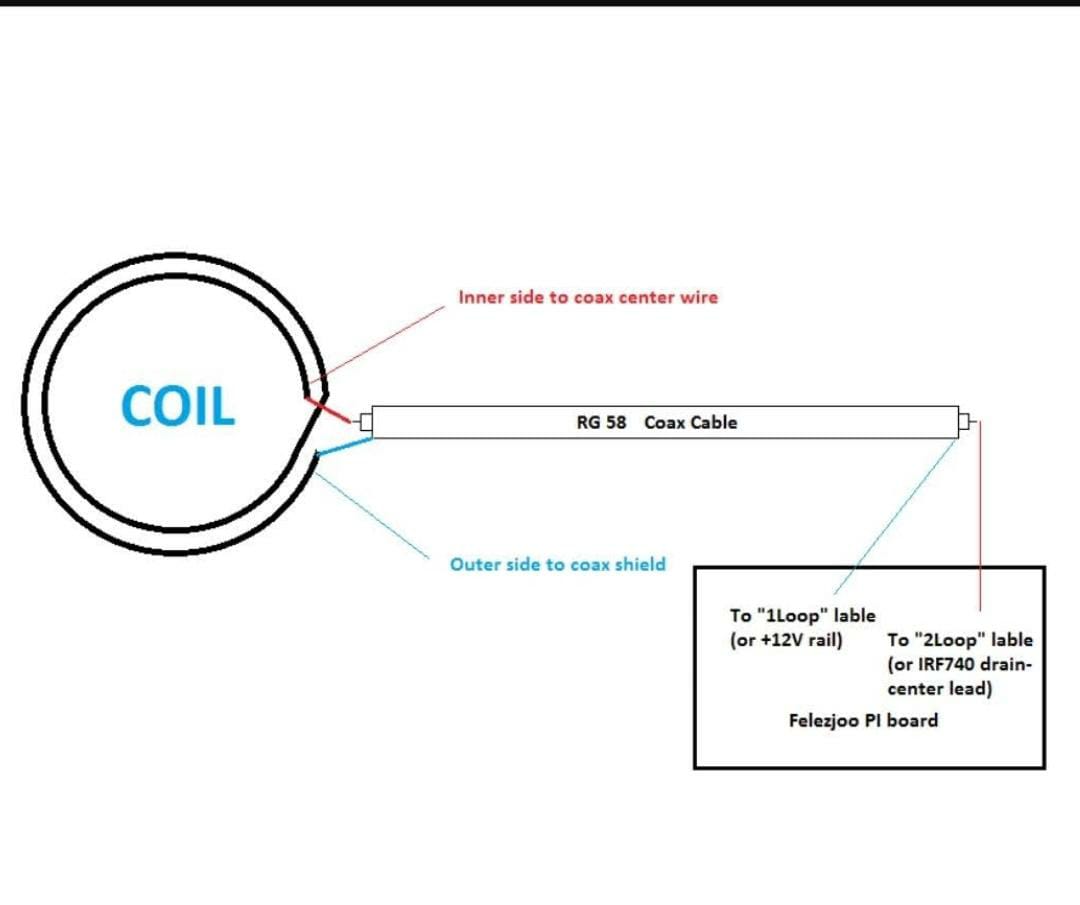

                for better operation, should + 12V be connected to the internal or external wire of the coil?
                  For better external result +12
                          perfect, i did it right, thanks!
