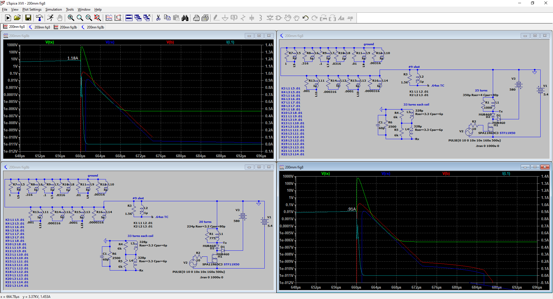

    Wondering if I've been using ideal number of turns for my coils. Tried a spice analysis with Tx 20 and 25 turns. Not much difference in signal strength. 20 turns higher Tx current. Does the spice analysis make sense? Would I get a similar result if I made and tested the two coils?

    Depends what "ideal" is for you. If we consider monocoils with the same wire size, more turns means slightly better sensitivity but at the same time increased coil resistance and less current through the coil. Less number of turns gives you more current through the coil and less parasitic capacitance hence a faster coil but less sensitivity. For this reason detectors have separate Tx and Rx coils.
      I've tried it, triple turns get double sensitivity... almost forget, not the same diameter (also three times smaller)
        Assuming a mono coil design, if there is no wire resistance then it's a wash. When you double the turns the TX ampere-turns drop by half but the RX induced EMF doubles. However, when wire resistance is included then more turns helps the RX faster than it hurts the TX. However... more turns also hurts the SRF and therefore you can't sample as early, and therefore you lose signal gain. Also, more turns decreases the SNR due to EMI because you are trying to use add'l turns to compensate for a weaker TX so while you are keeping the target signal about the same you are meanwhile boosting the EMI signal.

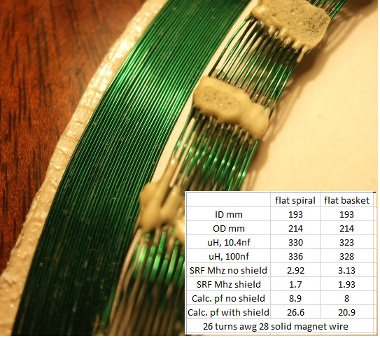

          The skin effect of solid wire may hold enough eddy currents to be detected as a target at low delays. Stranded wire tends to reduce this effect but Litz wire with insulated strands reduces the skin effect the most. The main point is that coil builders need to ensure that the wire they use for the coil will not hold any eddy currents longer than the lowest delay they use to find their desired targets. Is this a valid point worth discussing?
            Yes, that's all true but is independent of green's question. It seems that most gold PIs have settled on 300uH. Why is that? Will performance improve with more turns? Fewer turns? It turns out for a mono coil system 300uH is about right for sampling at 8-10us.
            Once you've decided the diameter & turns, the next question is wire gauge & wire type. This can get even more important if you decide to go for fewer turns as that translates into a higher peak current and a need for a heavier wire gauge. Then Litz becomes more important.
