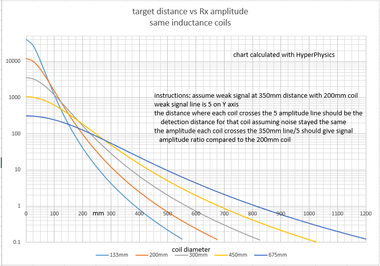

    hello, a question that bothers me after seeing a video where a guy had a test with the DEUS 2 he used the 22 cm disc and the 28 cm disc on the same targets and the targets were all found with the 22 cm but sounded worse with the 28 cm disc, my question is: if the detector is optimized for the standard 22 cm disc, does fitting a larger disc not require more current? because by changing the discs of the detector, the current supplied is the same and in my opinion, the more the disc connected to the detector grown, the more the detector should supply current to the disc n am I right?
    thank you

    Different size coils are usually matched for inductance which means their coil currents should be the same. This also means that the larger coil will have fewer turns so the "ampere-turns" will be lower than the small coil. This seems to suggest that a small coil will always be better because it has a stronger field but the field drops off quicker than for the large coil. This is why the small coil wins on smaller shallower targets but the large coil can win on larger deeper targets. In the video the targets were probably more suited to the small coil than the large.
      green has made a graph that illustrates this:
      https://www.geotech1.com/forums/attachment.php?attachmentid=56840&d=1646527293

          It's worth pointing out that the graph of signal strengths shown above is for a PI mono-coil, so is not identical to that of a DD coil on a VLF ( like the Deus2 ) , particulary when the target is close to the coil. However, the basic physics effects are still the same.
          But ... more importantly: You're forgetting the Deus2 has a great deal of the electronics inside the coil. Almost the entire machine, by some interpretations. Which means changing the coil size can come along with MANY other changes. Coil inductance does not have to be the same. Transmit voltage may well be identical. But receive gain ( analogue pre-amplifiers, and/or software sensitivity changes ) may be different. So comparing one coil with another has to be done cautiously.
