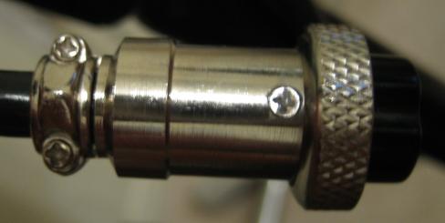

    First time ordering components. Which brand of shielded cable and fittings would you use? I'm building a 6" coplanar search coil. Ive attached a picture of the pin configuration. It is a Teknetics T2.

    Fitting
    Here is the fitting. Can anyone ID the brand and style?
      Brand/Style
      Visit: Thomas Distributing on the web and look in CB Microphone section. They have identical plugs that run from 3 to 6 pin and work on Minelab, Garrett and others. Should work on whatever detector you have.
      Hope this helps,
      Ty

            Hi Cicle C Digger,
            Still looking for that type of connector? This connector is a Taiwan brand. This is what dealers told me... They are very common in Asia and almost every shop I have been in Thailand, Malaysia, Singapore, Philippines, Taiwan, Hong Kong, Indonesia who sells electronic components have it. The price vary between USD3..4 for a connector incl. socket. The connector dos only come together with the socket. I never have never seen it seperate.... I'm using the same type of connectors for my detectors.
            Chris

                  Hills Components in Watford UK sell these they are 50p each (around $1) I don't have the part number but a search of their website under connectors might do the trick.
                  http://www.hillscomponents.com/main....&V6=0&V7=&PROD=
                  I can see if they still do them and buy some in, but with a minimum order of £35 ($85) I'll have to get some serious orders from people on the forum to justify this in fact I'll place a MOQ of 10. Sorry but can't afford to make a loss.
