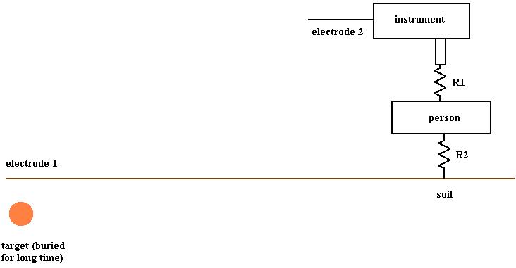

            Ivconic: I detect it many times with open base NPN or PNP transistor system. I know about the gas or light emanated from this buried for long time metals. Also detection deppend if you're positioned in plain terrain or high terrain.
            So, my conclusion is this: small electric field in order millivolts exist in vecinity of for long time buried good conductive metals (small size).
            Bronze and copper are more strong. Silver and gold less in concordande in grade of corrosion. Round objects "has" more "signal", etc.
            Esteban

              • #52
                "...open base NPN or PNP transistor system.."
                Can you define this?

                  But also nobody gave sane explanation of it so far.Fact.
                  ivconic,
                  you might look up the following website: http://corrosion-doctors.org/index.htm
                  There you can see the Galvanic Series of metals. Any time you have 2 dissimilar metals in contact with each other through an electrolyte, you have an electric potential.
                  In the instance of gold and zinc, for example, this potential is about 1,25 Volts. The amount of current flowing between the 2 metals will depend on the quality of the electrolyte and the surface area of each metal.
                  Any time you have some current flowing, you have ion migration and an electro magnetic field.
                  Plain facts out of the text book.
                  In many places of the world where gold nuggets are found, the nuggets are covered by a dark brown "patina". This patina is manganese oxide. The manganese ions migrated to the gold nugget and stuck to it because of the electrical potential between the 2 metals.
                  Not too far from where I live, in one specific valley, the gold nuggets are covered by a green patina. The gold prospectors tell about the size of the "green gold nuggets". Could that be some cuprous oxide?
                  Now, our metal detectors are designed to be able to detect minute electro magnetic fields........
                  Tinkerer

                          "..There you can see the Galvanic Series of metals. Any time you have 2 dissimilar metals in contact with each other through an electrolyte, you have an electric potential.
                          Plain facts out of the text book...."
                          * 2 dissimilar metal, one near (or in contact) other is one thing - metal alloy is quite another thing.
                          * ground battery phenomena is known to me,you dont need to explain much
                          *current flowing,ion migration.....em field? which type of current you are talking about here?
                          Yes, logically, we can bury battery in a wet soil and perform some tests...right?
                          • #58
                            Maybe this is more clear... or not?

                              • #60
                                So it looks like a better response can be obtained by detecting with bare feet, and not wearing rubber soles.
