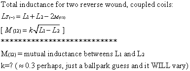

        However, it is customary to buck the transmit coil and there is probably more information available for this approach. The general idea is that (almost) complete cancellation occurs between the TX and RX coils - except when a target is present to upset the balance. ANY geometry that works, can be used . If you want or need a balanced transmit coil (and using twisted pair wire instead of coax), then bucking the receive coil may be appropriate to minimize energy radiated from the TX cable.
        Concerning PI detectors, as Aziz stated [ less over-voltage problems of the RX side (inductively not coupled to TX)], a properly nulled 3W concentric coil might be used advantageously in a PI detector because it may eliminate a high voltage that would otherwise be applied to the receiver (and this negates the need to use a noisy series resistor, or having to implement receiver blanking - else fry the receiver amplifier) but I think you may lose sensitivity using a 3W concentric coil in a PI. Ground effects are also minimized, but, again, at the expense of reduced depth capability. Also, we don't want a high PI transmit inductance because we desire fast turn-off of PI coil current. I think IB coils generally have about 500x~1000x more inductance than PI coils. IB and PI coils are different animals and have different considerations. In a PI detector, I would be careful about relying on coil null to protect the receiver input, but it is possible and may be more commonly used than I could know. But, PI coil inductance should be very low compared to an IB coil. Apples and oranges.
        Although the math is not extremely complicated, 3W coil calculation can still be daunting. Besides the need for proper winding ratios and proper orientation to obtain a good null, because of an unknown "k" factor (coefficient of coupling) calculating total coil inductance is not so easy when a reverse-wound bucking coil is included. Total inductance, and also the correct orientation/turns ratios must be considered. Why re-invent the wheel, so to speak? At least with a DD coil, there is no need to calculate the bucking coil, because there ain't one. Also, there there is the omega coil - that when properly constructed only requires proper orientation of the RX coil in relation to the TX, to obtain a null. (Look at the Magnum IB for an example.)

              I believe there is a direct 1:1 relationship between radiated power to coil current and/or number of turns. As you double either #turns OR coil current you double radiated power. Carl Moreland addressed this issue in one of his papers, I'll see if I can find it... but I seem to have lost it.
              However, there is a disproportionate increase in a coil's inductance that results from adding turns. This disproportion depends on the particular geometry of the coil (flat spiral-wound [FSW], donut, helical, etc.) but I think it is most profound with FSW. This is because as more turns are added to the outside, each additional winding adds more inductance than the previous one did. Helical coil (don't have much use in metal detectors) or donut coil inductance will more than double with a doubling of turns because (in addition to the obvious inductance increase due to added turns) there is also mutual inductance between the windings. But, the inductance of a FSW coil will JUMP as more turns are added.
