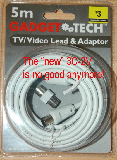

    In the thread http://www.geotech1.com/forums/showthread.php?t=15383 I was refering to a coaxial cable that is very suitable for metal detectors. The cable has low capacitance, small diameter, flexibile (although it has solid core). Besides that, is very cheap and (good news for Australians), it is widely available through the Reject Shop channels.
    At least, this is what I thought when I found it in the store...

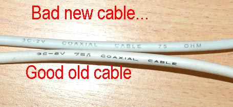

    The sad and intriguing truth is that they look the same, they even have the same code on them, they are very different.
    It happened I went today to Reject Shop (looking for cheap goodies that I could use for building metal detectors) and I came across the same type of cable that I described in that thread. I bought 5m for $3. I decided to measure the capacitance of the whole cable, to have a better precision.
    Both my old cable and the new cable, just purchased have about 47pF/m (which is 14.3pF/m). The total resistance measured is about 4.3ohm, which is about 0.9ohm/meter (quite different from the value of the old cable, 0.38ohm/meter).

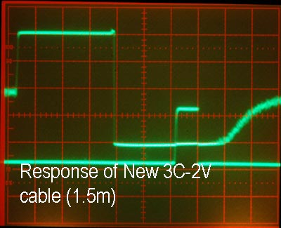

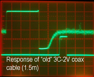

    The biggest difference can be noticed in the latency of the pulse, as can be seen in the next images.
    Imagine what would have happened if somebody else would have tried the new cable, after my warm recommendation...
    The intriguing thing is what makes them so different??? It is not the capacitance of the cable, and the resistance of the cable has very little influence. Could be their 75 ohm impedance slightly different? Hard to believe it could have such an effect.

      I didn't think of trying to detect the cables, to see how they react. The difference is clear as day from night. The bad cable is detected from about 10cm (no matter if is straight or bent), while the good cable is not detected at all, either straight or bent!
      Now I think that the "good" cable is not detected maybe because the delay introduced by my setup (using the same cable to connect the coil) prevents prevents the test cable from being detected. I think a faster detector may detect my good cable as well.
      The pulse at TP4 changes a lot with the bad cable. Even my previous good cable that I was using (the high quality audio cable) is still detected at around 2-3cm.
      They must be using some different metallic materials (either composition or size, thickness, etc) in the construction of the new cable 3C-2V. Now I know how to test a cable, if it is good or bad, even before connecting it!
