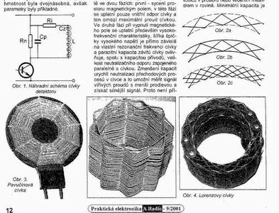

                Re: Coil - PI
                Found in a technical museum. The first coil is the "spidernet", followed by Lorentz coils of the first and the second order. The voltage peak with such a coil makes the halfwidth about two microseconds and take care of FET driver, the voltage peak can rise over thousand volts. Sid
