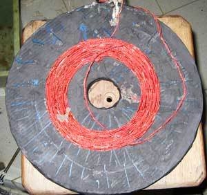

Single layer Spiral coil
    I wouldn't play with any core because of the added weight. There were some designs employing ferrite rods, but not a complete horseshoe.
    You may think of a humbucker as a cross-section of a torus. Because air gap is very large here, don't expect to gain any benefits from any kind of core and feel free to abandon the core idea altogether.
    A picture? usually such configuration is referred to as OO and it depicts it well enough. If in one "O" current flows in clockwise direction, in the other it flows in opposite, and they are connected in series. That's it.

          I made this now as you Davor suggested. It has outer diameter of 20cm and the inner coil diamemter will be about 8cm.
          www.youtube.com/watch?v=RsWQ6vytNwk
          What do you think of this?
          I think of addin 2 coils in series. The inner coil has opposite direction as outer one. Would they produce quite nice magnetic field?

            Nope. I suggested coils of the same size side by side, one next to the other. This solution in video is as per Tinkerer's solution.
            Go for it, Aziz also speaks fondly about this configuration.

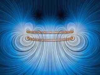

                Here you see a spiral coil with the graphite shield and a spiral Bucking coil on top.
                Tinkerer
                  Ah! So the tandem is a proper name. Thanks. Anyway, you can see a (somewhat squashed) toroid organisation of magnetic field in there. Exactly what I was talking about.
                  You have nice visualisations, including the one in your avatar. I am seeking some software without learning curves, and I hope you can recommend some. It is often straining job to picture all these configurations in my head.

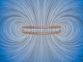

                    For a visualization of coil fields, compare the 2 pictures below.
                    With the current in the 2 coils running in the same direction, the fields are aiding.
                    With the current in the 2 coils running in opposed direction, the opposing fields repel.
                    A RX coil positioned in the position where the magnetic fields are rarefied, will sense only a weak TX. This is what we use to reduce the Flyback peak, in the RX. We call it a Bucking coil.

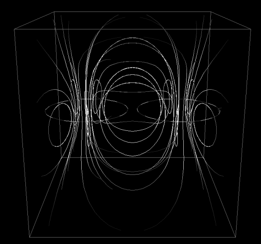

                        Here you can download free applets for all sort of visualizations. Excellent site.
                        http://www.falstad.com/vector3dm/
                        Enjoy
                            Enjoy
                            Tinkerer
                            That's more like it! That's exactly a tool I was thinking about: no learning curve at all

                                you are still after a "sexy" coil software.
                                Just found it, thanks Tinkerer. The script works like a dream. It would be a tad better if I could enter my own coil designs.
                                I'll have your kind offer in mind when I manage to design something that is not already in use /patented /misunderstood etc.
                                This tandem coil thing with counter phases (a torus stand-in) works exactly as I imagined it, and I think it must work well in "monocoil" solutions.
