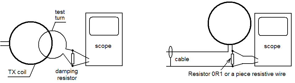

      Barry, when we use a test turn connected to a scope, the scope shows only the derinative of TX current i, ie
      e=k(di/dt),
      where k depends on geometry (number of turns, turn diameter and distance).
      The voltage across TX coil differs in form from pure derivative because contains in addition a component depending on coil resistance r, ie:
      u=i.r,
      where i is TX current.
      The method with test turn is very convenient for adjustment of damping resistance because changing distance we can observe ringing at full screen.
      To observe TX current, we can connect a piece of resistive wire (for example 0.1 ohm) in series with cold lead of TX coil (before cable as shown below). The voltage across this resistor is also convenient for adjustment of damping resistance because there is no flyback voltage.

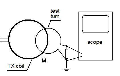

        does it matter how the test turn is orientated ?
          e=k(di/dt),
          u=i.r,
            Yes, does.
            Taliesin, the mutual inductance M between two coils can be positive or negative depending on which lead of test loop is connected to ground of scope.
