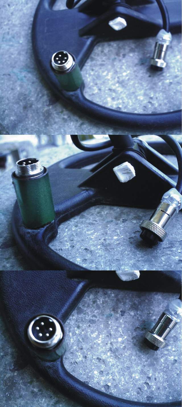

    My most favorite coil ever is Minelab TS1000 coil.
    I had and used dozen of those so far.
    Why "most favorite" - because it showed best performances among all other coils i had so far. Also versatile, can be used with bunch of different hand made detectors.
    Despite that, final design is suffering from one major lack: cable!
    In the past, first series of those coils were with much better cables.
    Don't know what happened, but last series coming with very easy "perishable" cables!?
    Usually cable suffer from cracks and breaks at those 2 inner coaxial, after just of few months use!?
    And almost by the rule (Murphy! ) those cracks, shorts, breaks appear at very bottom of the cable, exactly on place where cable entering the coil enclosure!
    So, very soon, that magnificent coil turns unusable...
    I had numerous TS1000 on service so far.
    Usually i "dig" into it and replace cable.
    But recently i decided to try another "technique"!
    Splendid!
    Now there is no chance to lose that coil forever!
    Idea was not mine, i saw same solution at Turkish Atlantis Imperator II.
    Cable connector is soldered closely and fixed with joint filler, epoxy...
    Unbreakable, water resistive, simple and easy...
    From now on; i am planing to do the same with all my next coils...
    Does the metal of the connector not affect the induction balance of the coil?
      Seems not. I made connection (naked wire around connector screw) with TX shield.
      So...behavior remained unchanged.
      I also have 18cm (TS800) and 45cm (Excellerator) coils for Musketeer.
      So i made "parallel" testings with all coils and same detector.
      Seems there is no problem at all.
        At old vintages there were metal screws to fix coil on shaft.
        I wandered many times about those screws..
        Also at some vintages, metal part of shaft was longer and plastic end of shaft was much shorter.
        So plastic part was barely 10cm long.
        Yet, such vintages could detect and discriminate well small targets above 15-20cm distance.
        I also wandered about that.
        Seems smaller "fixed obstacle" (or how else i can put it) does not affect coil balance...at least not significantly.
          Or maybe because connector is quite offset, relating to crossing section of DD coil, and that's why it is not affecting balance, to bother?
          Can't tell exactly why, but seems it is not causing problems at all!

              Yes, good solution if you live in arid region as Anatolia, otherwise problematic, because moisture can shortly penetrate coil connector during wet grass searching. I am more CON than PRO of such solution or you need special waterproof connector.
                It is already good protected.
                Moisture will have chance to penetrate in lower connector same as in upper.
                Once connector closed and screwed - low chances moisture to make any damage.... except in case i soak whole coil into water...which i will not do for sure.
                Besides... i can later apply thermo coating over cable and connector. At the time i hadn't proper diameter..
