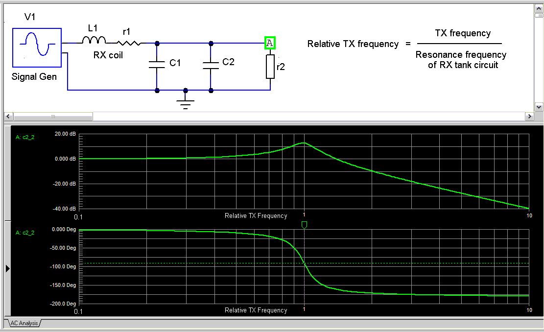

                One way to get a feel for it is to use LTSpice or a calculator to plot the frequency/phase response of an RLC tank (resistor, coil, capacitor) connected as in your MD circuit. The "R" will be the equivalent resistance of your coil, which actually could vary with frequency). You will see how the phase of the response relates to the TX frequency (and the Q of your tank circuit). You will also see how the gain of the response relates to how far you are off resonance. That "1.19" factor is a reasonable compromise where you have very little phase shift due to resonance and still enough gain. But that does not preclude other designs.
                -SB
                  SPICE of RX input
                  RX coil operates as Second Order Lowpass Filter.
                  The old metal detectors of White's operate at relative frequency almost 1.3, but the new one operate at almost 0.5. The incompetent designed metal detectors operate at relative frequency 1, where the ground causes significant parametric amplitude and angle modulation of received signals.
