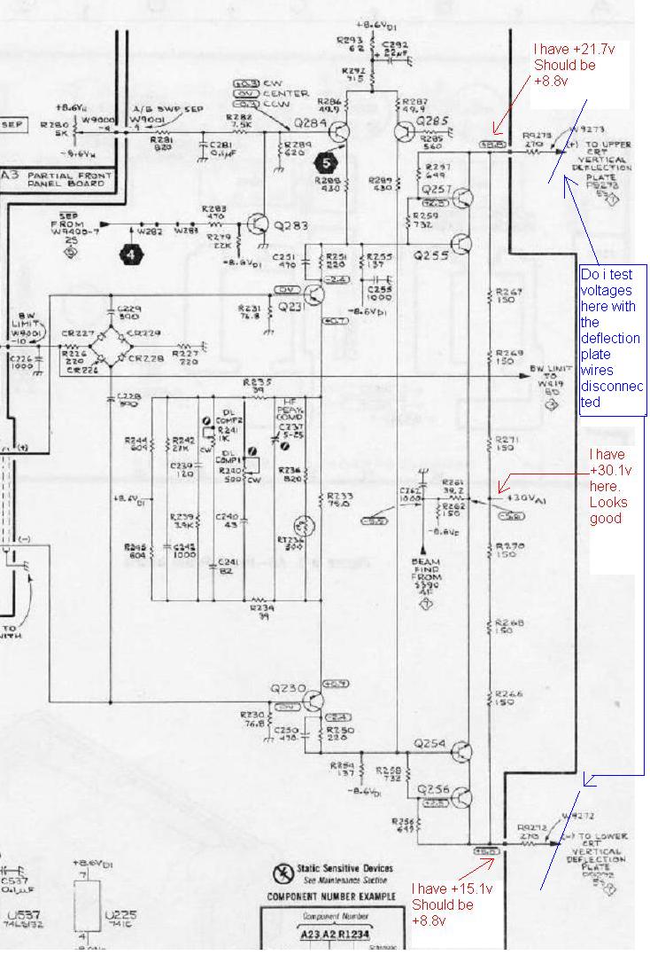

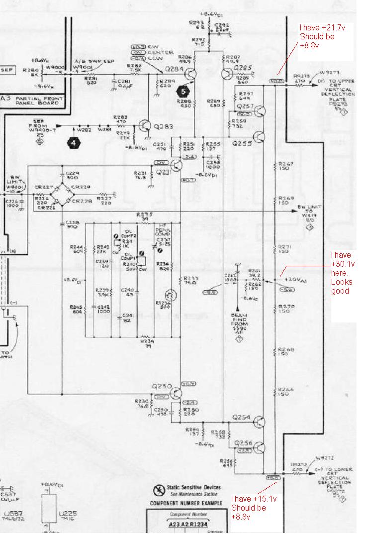

            So there seams to be a problem there wm6 What i have noticed so far is the measured voltage between r266 and r271 at the 6 x 150 ohm resistor voltage divider network. +30v is present in the input of the divider network, but the upper vertical deflection output voltage is +21.7 volts and the lower is +15.1v with unit turned on...They should be both +8.8v. The supposed +8.8v X 2 measured voltages go to the CRT, but do not look to good so far.
            The measured on board resistance between each resistor 150ohm's x 6 are all 141 ohms. I think its within spec because me multimeter might not be that accurate at so low ohms readings.
            I have done other tests on the sub boards from the front panel and all are good. so it looks like i am in the right part of the main circuit board.

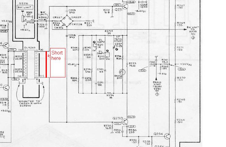

              Can you post Y-amplifier part of scope schematic here, in readable resolution, to imagine what we are talking about?
                I hope this is readable. I have a on-line scanned copy of the schematic and is hardly readable for me too.
                Cheers Sid

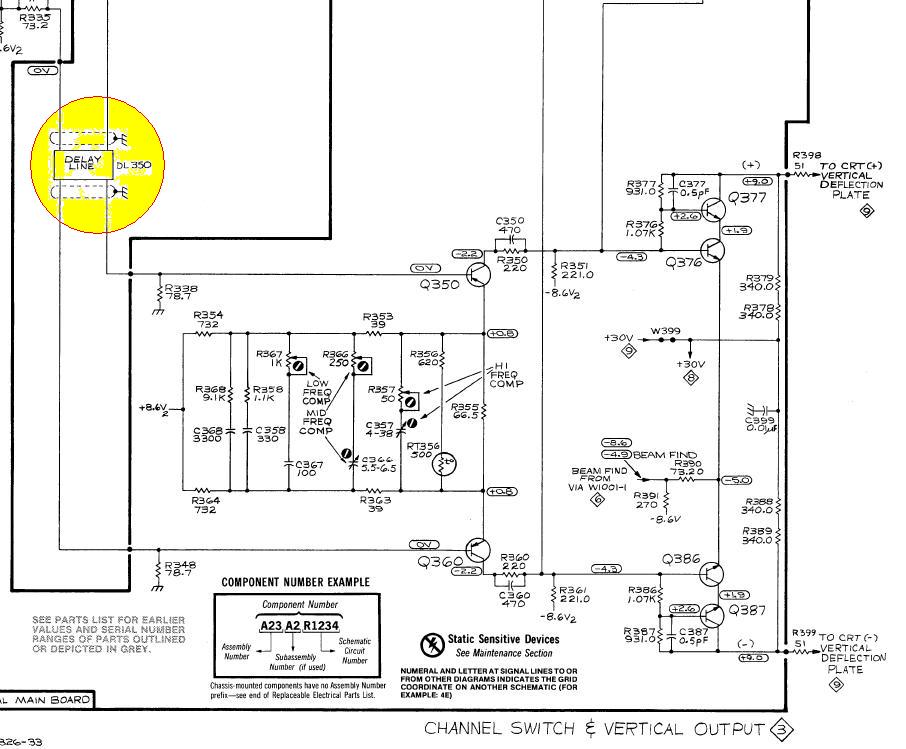

                  Yes, it is readable, thanks.

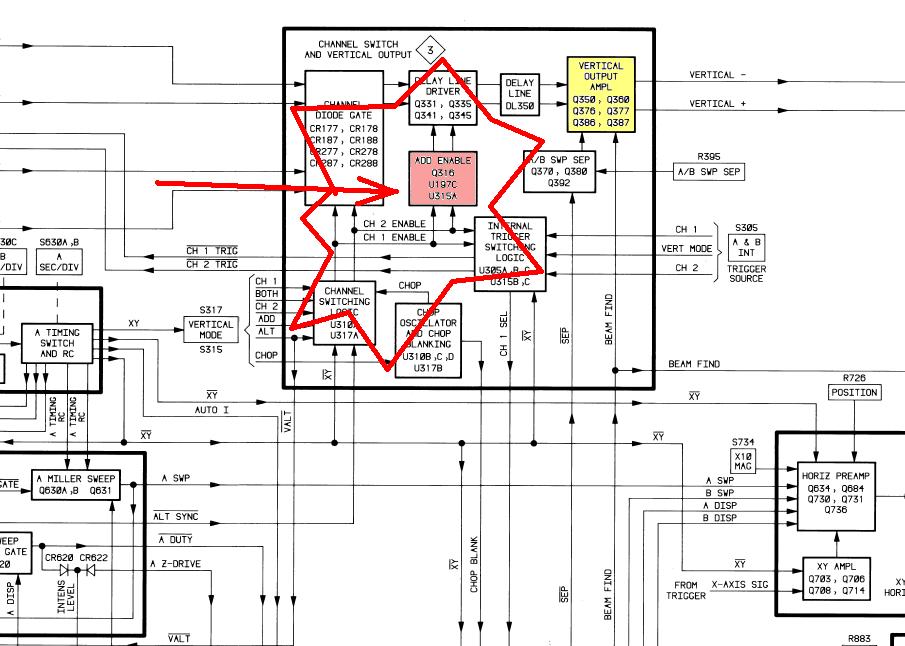

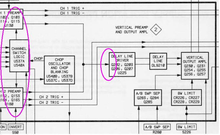

                  But what you posted is Y deflection amplifier, a part of whole vertical scope circuit (yellow marked on block diagram I posted).
                  My presumption on faulty working is on red marked part of circuit or something around it:

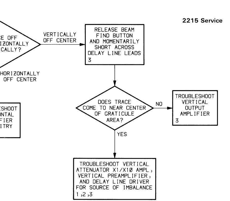

                    Additional check:
                    I downloaded 2215 service manual now and found this part of troubleshooting diagram, that suggest this check too: to short momentary delay line leads for check of trace moving:

                      I noticed it says to short the delay lines to see if the beam centers in the middle of the CRT....Does that mean to physically short the delay cable between R338 and R348 on your schematic.

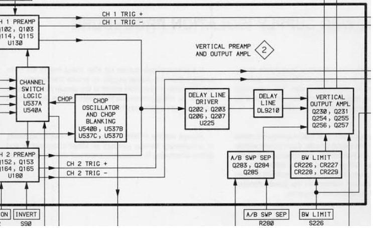

                      BTW your schematic is for the 2215 model, same principle, but different component labeling. Not a problem here. Circuit block diagram on your 2215 document is slightly arranged different to my 2215A document. See below. Which circuit block are you referring on my document compared to yours posted below??
                      Another question....when measuring voltages around this circuit is the deflection output wires supposed to be disconnected from the CRT?? See Pic below.

                          I think your analogue circuit part is to find here:
                            Yes, momentarily only, and look between shortage at display what happen, then consult troubleshooting diagram I posted:
                              Yes, you need to physically short it for a moment. Use two (instrument) binding cable with clamp on one side and connect it to delay line leads. Look at display and short cable end for a moment. Consult troubleshooting diagram on what you see on display.
                              No, you don't need to disconnect leads to CRT deflection plates. Probably your voltage is according your beam trace deflection position and you can take it as OK for now. Check first marked commutating circuit that integrate both channel together (measure all voltages around it and check visual part status, if possible measure some parts value - electrolyte C at least if exist).

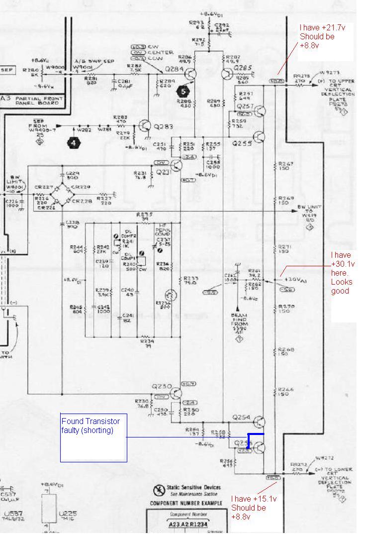

                                Hi Wm6, I momentarily applied a short circuit to the delay line and the trace did not go center ... actually moved slightly further up on CRT.... therefore the service manual was referring me to the likely cause of fault in the Vertical amplifier section below.
                                I therefore tested most components so far on the below circuit and have found the Q256 transistor shorting which is starting to look as the problem i am experiencing. Every other component nearby Q256 tested ok.

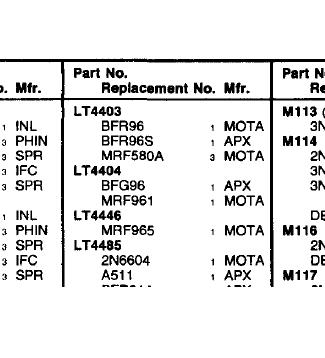

                                The part is a LT4403 manufactured by TRW (No longer in Business) and the part has been discontinued.
                                The only reference to a suitable replacement is a BFR96 as noted below. I cannot even find the datasheet for LT4403 so i can compare pin layout or spec's to BFR96.
                                I happen to remember i have a few BFR96's from some old UHF radio gear from me radio days, which i will remove and re-fit. I will further test the rest of the components to be 100% certain that the new/used part does not fail again due to other component failure.
