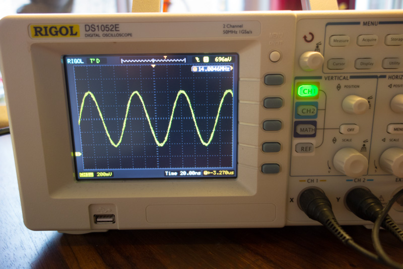

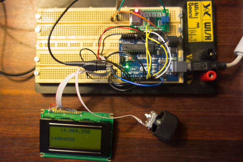

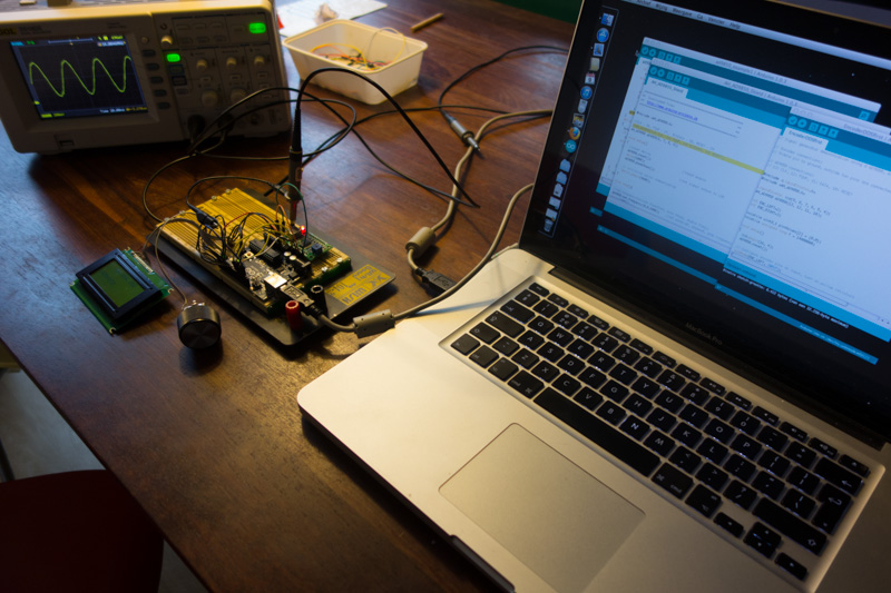

    My latest project is about building a simple DDS using a AD9850 board I bought off ebay for only 4 euro. I spent one evening putting together a working 14 MHz sinewave generator controlled with a rotary encoder and an LCD display. All controlled with an arduino UNO and about 70 lines of code.
ID:	368228Click image for larger version
ID:	368229Click image for larger version

      I've got a similar looking one, too. It seems nice and clean below 10MHz or so, but the output filter is less than stellar unfortunately! It's good for a lot of things, though it does eat relatively lot of power.
        Yeah, you need a good low pass filter at higher frequencies. Haven't looked at the power, thanks for the tip.

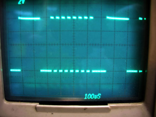

                      Do we really need sine wave to build multi-frequency detector? Most successful and popular multi-frequency detectors using meander instead of sine wave in their non-resonant coils. (Minelab Sovereign/Excalibur, Fisher Quicksilver CZ series) Looks like it is cheaper and easy to process digitally.
