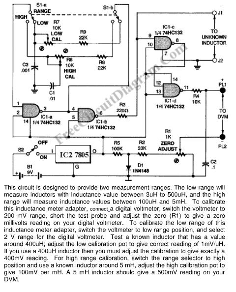

    Has anyone built and tried this circuit?Click image for larger version
    I'm at the point where I need to locate 2 inductors to calibrate it and thought I'd ask if it's worth using. I should of asked before I started.
    Thanks.

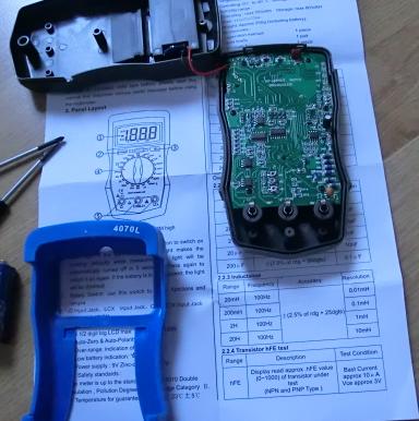

        As cheap as $10 Chinese RLC meter model 4070L look from inside like this:
        It is good enough for "homemade" coil builder needs. It even has transistor hFE measurement.
