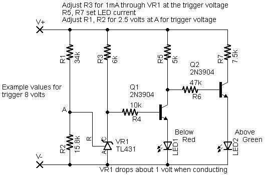

    I am again in game and thinking to change this part for following second generation of boards Delta Pulse. offer something - has to be simple, effective, guaranteed good working, may be used LM393, or TL431, or LM358, etc., has two three LEDs. anotherway WHAT you want to see what you are prefer.
    old LBI diagram I took from net is not so good... attached Click image for larger version

    Do something like this. http://electronicsproject.org/battery-voltage-monitor/

        with lm358 http://www.autospeed.com/cms/article...Monitor&A=1369
