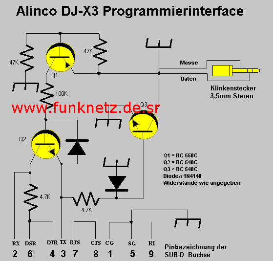

    hi all i'm making an interface for my alinco djx3 and djx3s and really need this translating.
    its simple but i cant read it, the words that is, diagram no problem, thanks in advance.

    klinkenstecker = jack plug
    widerstande wie angegeben = resistors as specified
    pinbezeichnung der SUB-D buchse = pin name of the D-SUB connector
