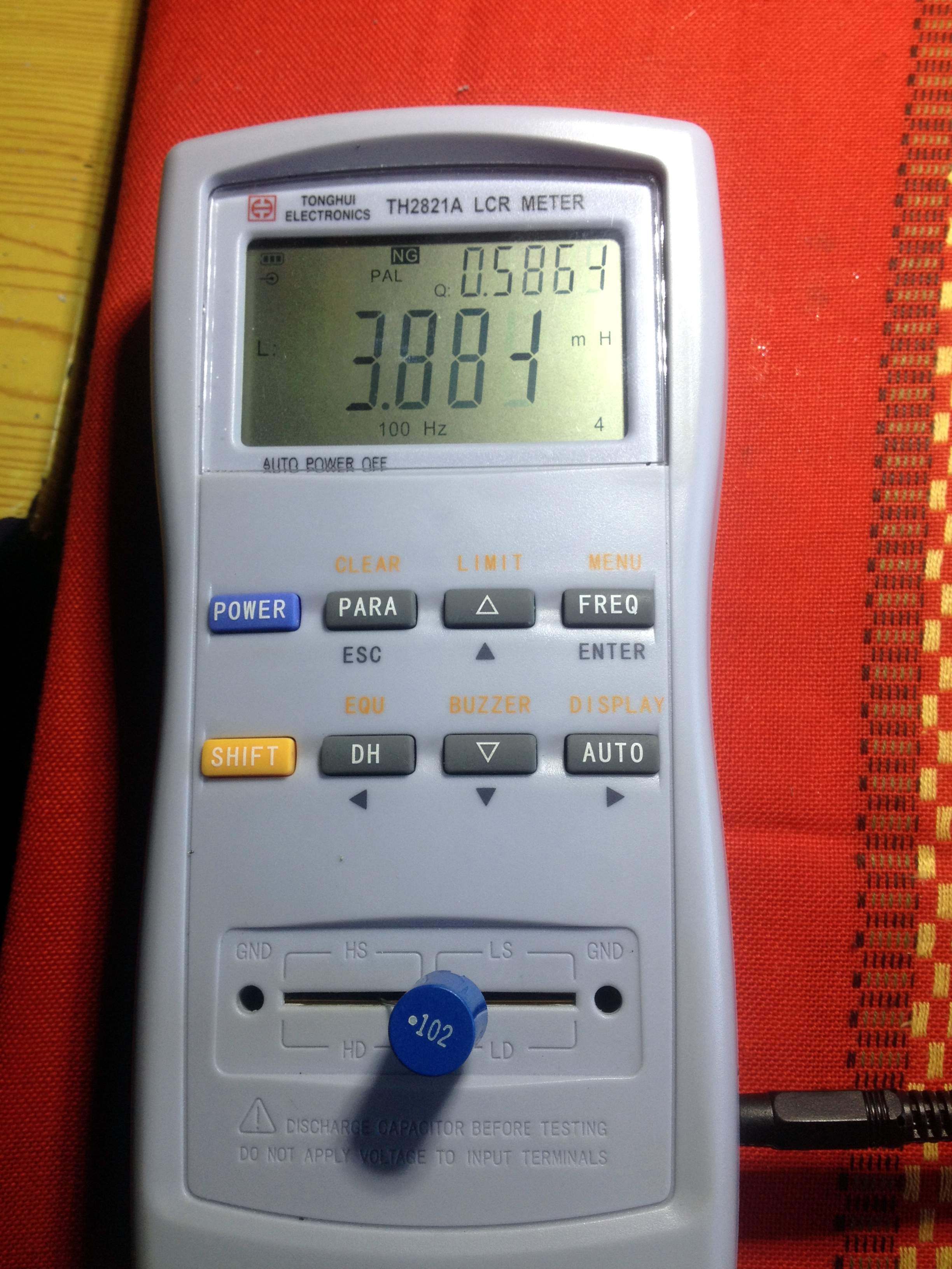

    The other day i obtained handheld digital LCR Meter TH2821A .
    New tool for me. So far i had only multimeter lookalike L meters with ranges 2mH to 20mH.
    But this one, the TH2821A, is somewhat more serious tool.
    It can measure L, C, R, Z and Q at coils.
    It can measure at 100Hz, 120Hz, 1kHz and 10kHz.
    So i was thinking to perform series of measurements on few coils that i already have.
    One coil is Detech 38x30cm (15x12") coil for MXT | MXT PRO / 300 | DFX / 300 |V3 V3i / Spectra | M6 models
    Another coil is Black Max coil which came with White's 6000 Pro Xl.
    Both original coils, both well known, both perfect for learning and mastering the new LCR meter.

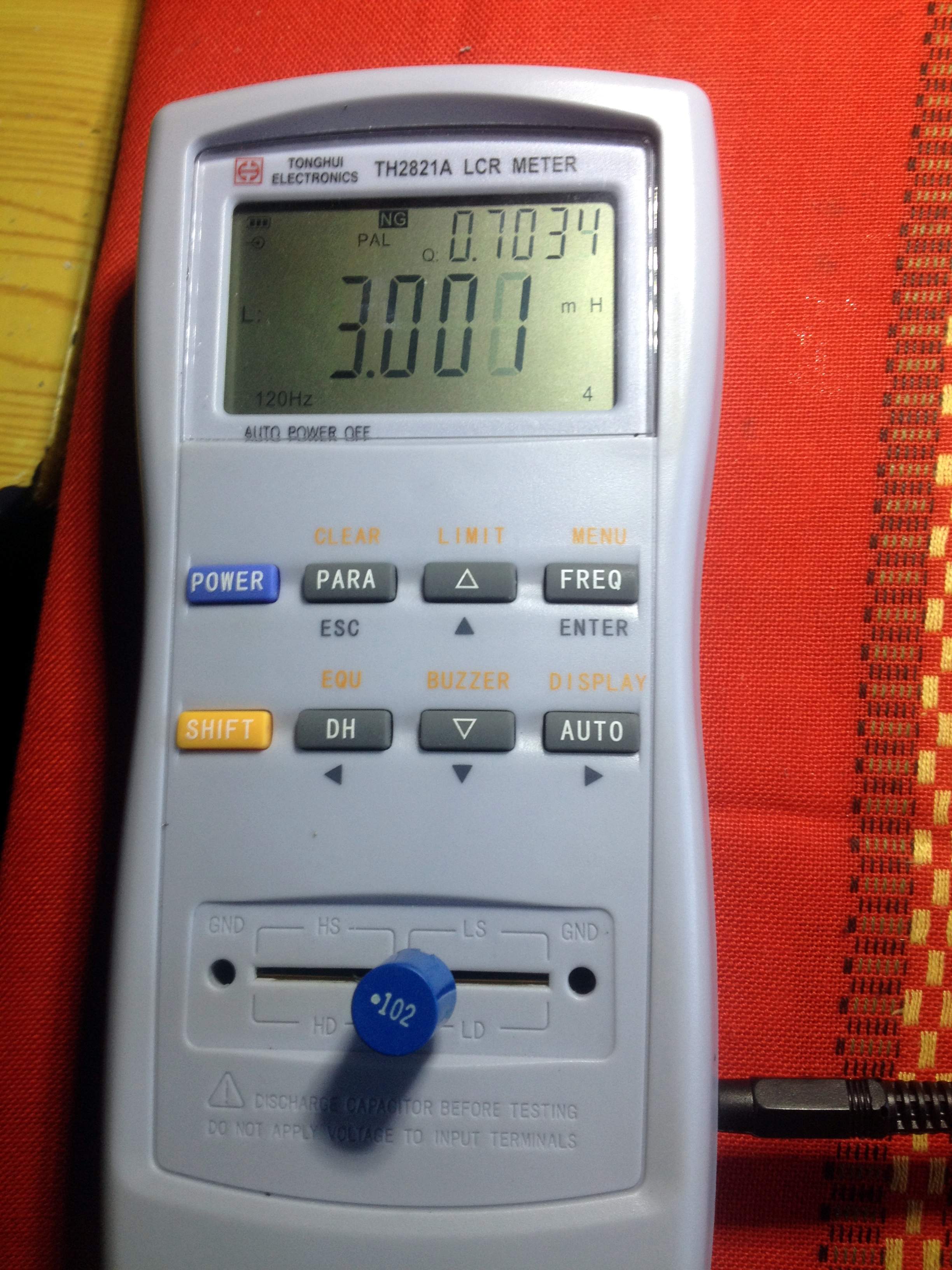

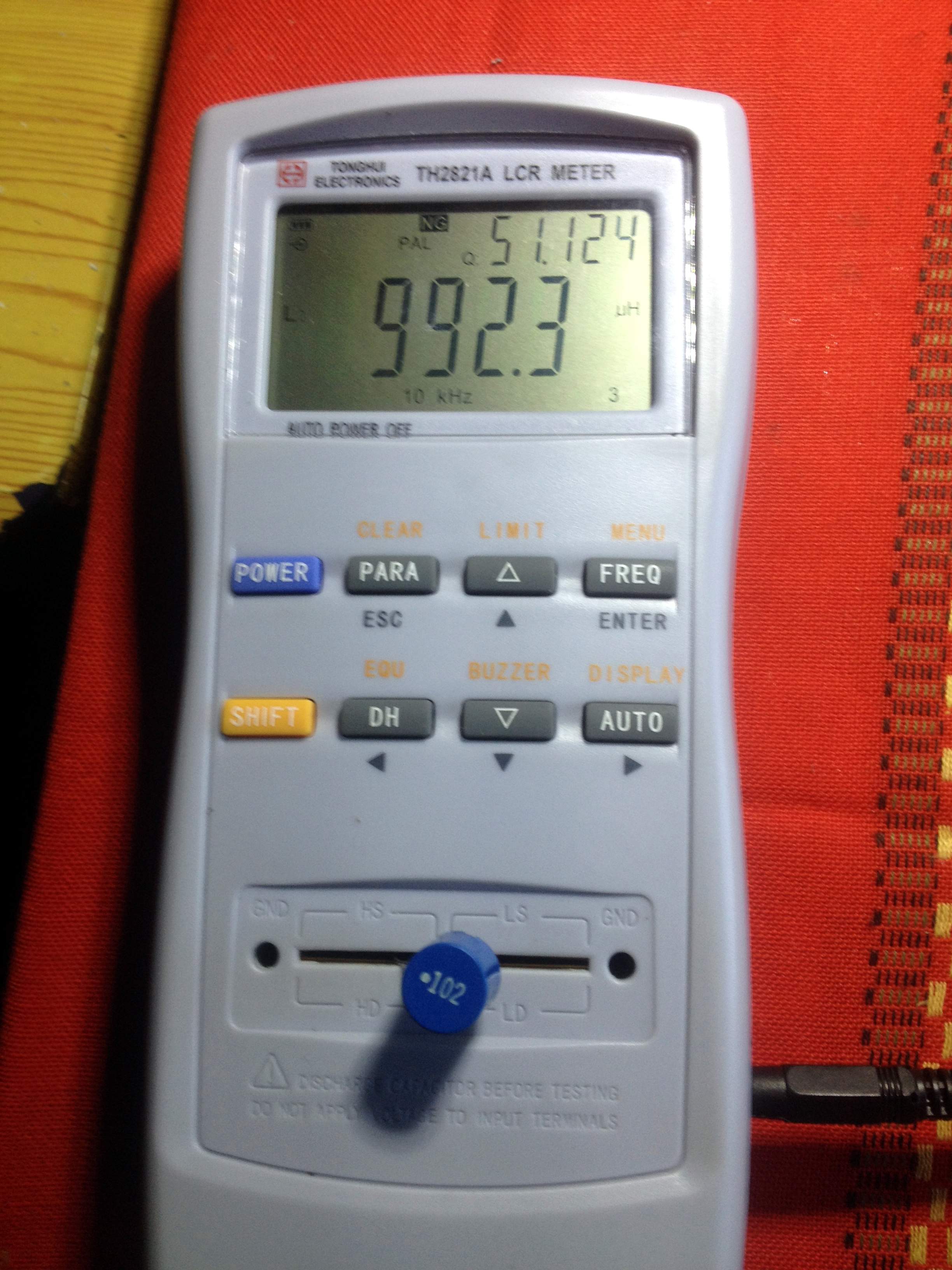

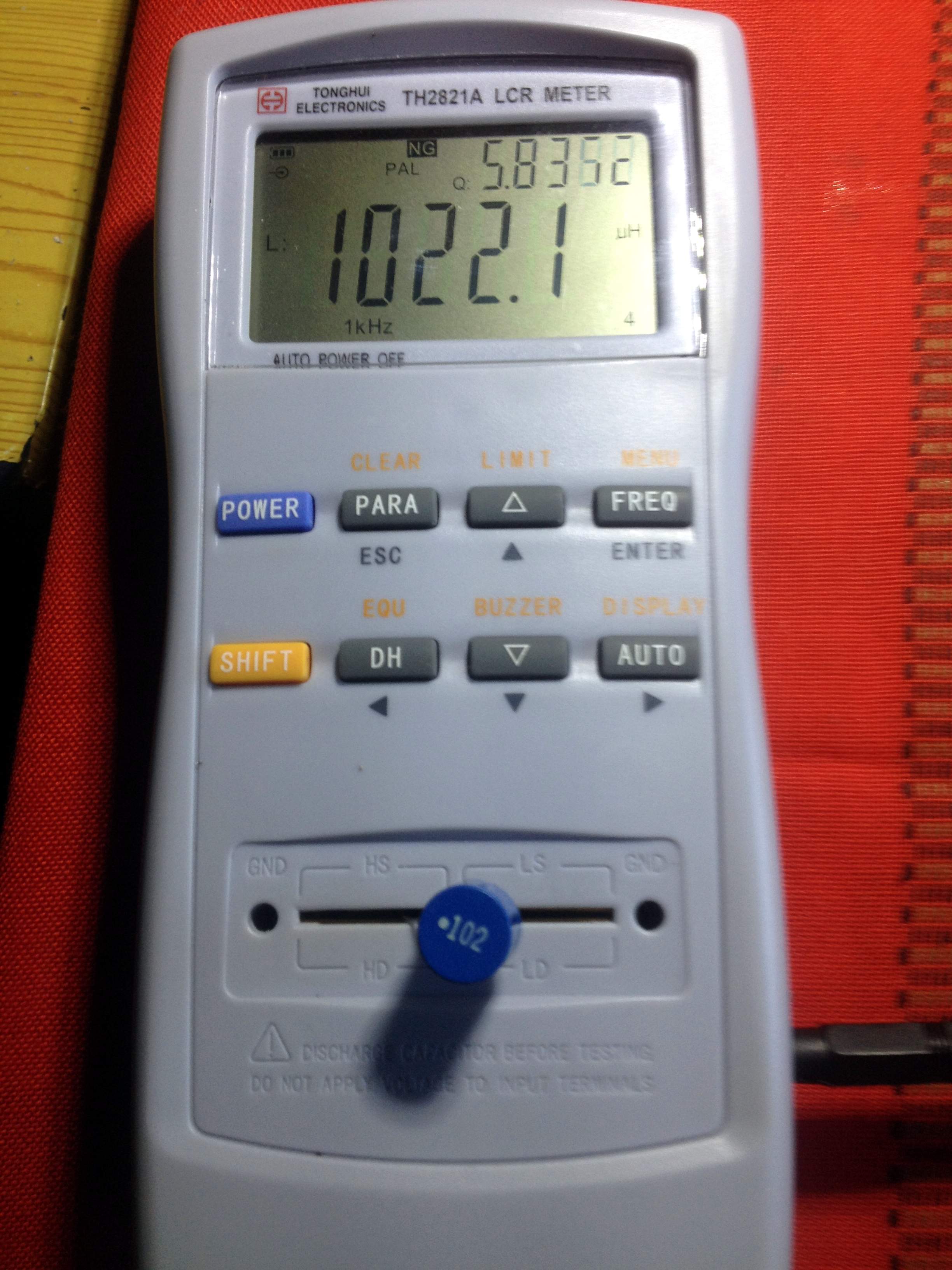

    So i performed series of measurements. And i got somewhat confusing results at the end!?
    If i was not knew from before the real specs of those two coils; how could i tell which one of measured result is accurate?

    Some of the readings are so off the wall as to indicate something is very wrong.
      The SEF should be close to the DFX numbers. The Black Max should be close to the Spectrum numbers.
      Ivica, this thing looks totally screwed up. Get a known discrete inductor and try that.
        Yes i think so too.
        It seems LCR is faulty.

          Searched the Internet... apart from obscure manual; there is no schematic nor repair&servicing tips.
          There is a LCD sign "NG" displayed all the time. According to manual it means "No-Good" !??
          But nothing else explained on that.
          It is second hand, way long out of warranty.
          Therefore i am on my own

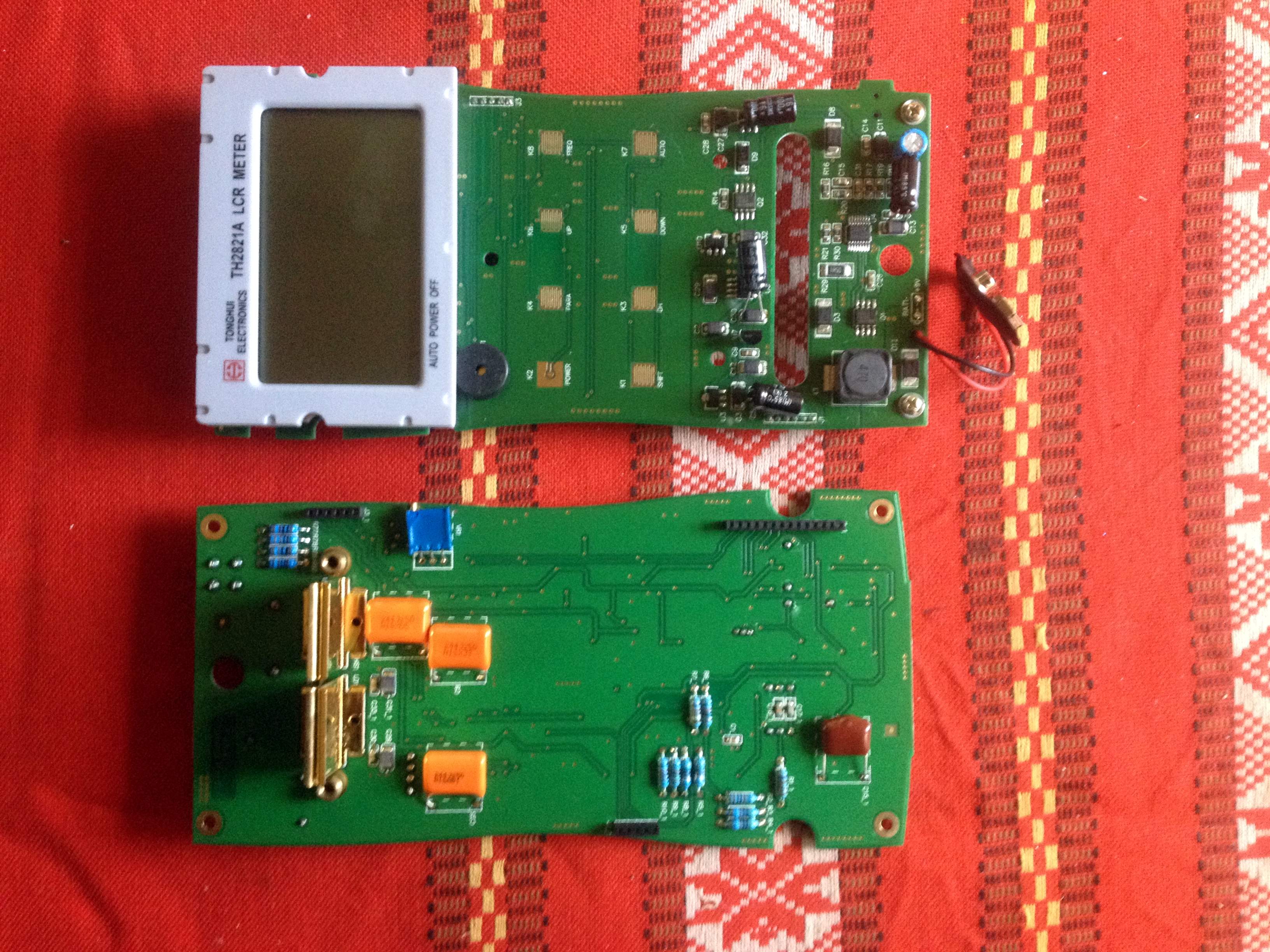

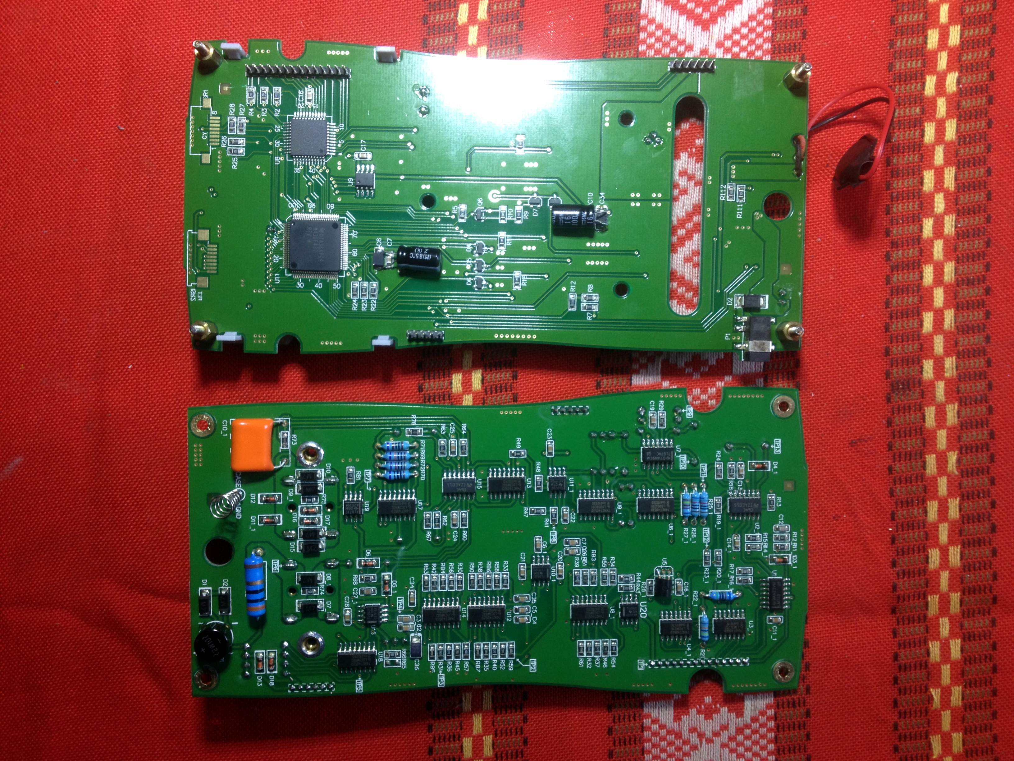

                A hardware...
                Ouch!

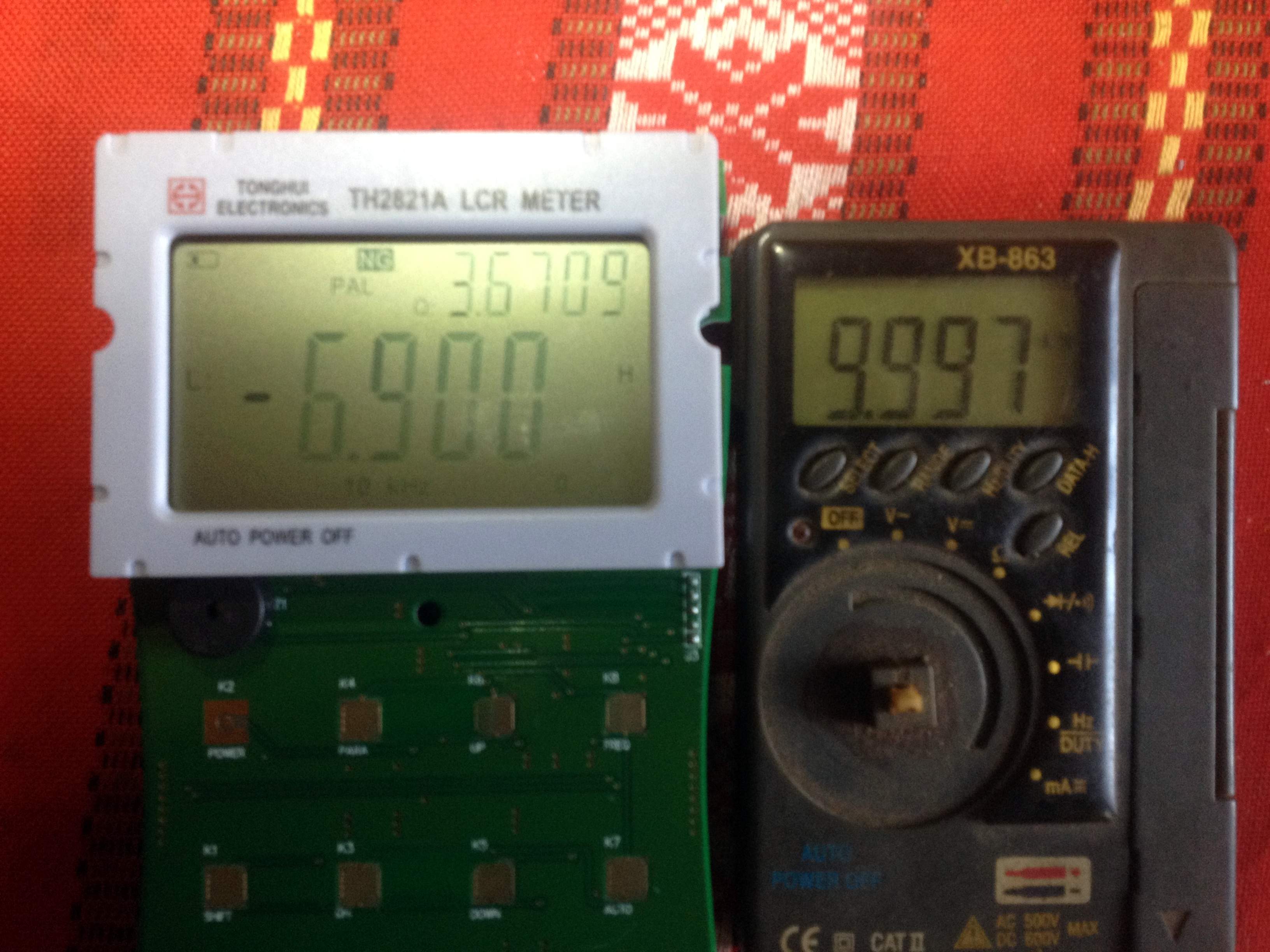

                  At least counting frequencies are pretty accurate, meaning further that uPc part seems to work correct.

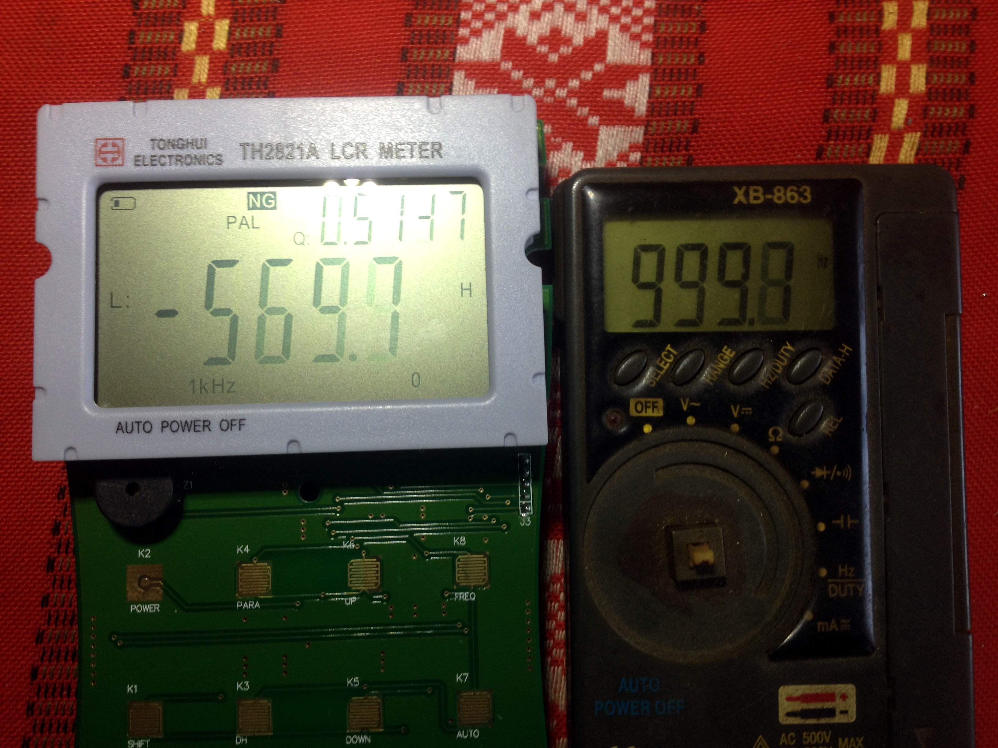

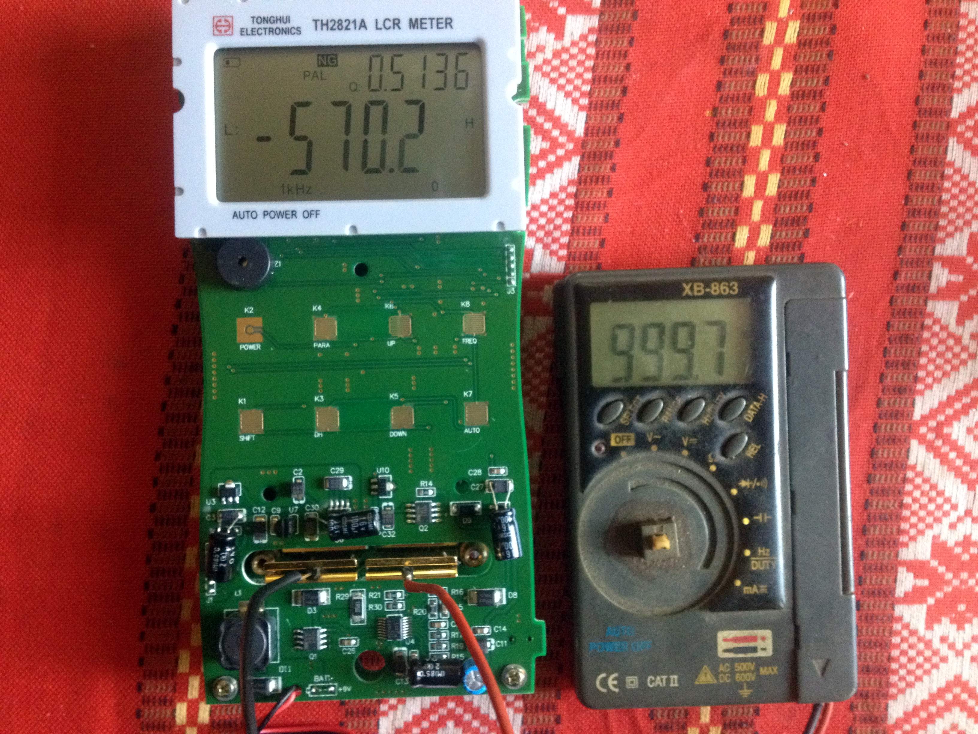

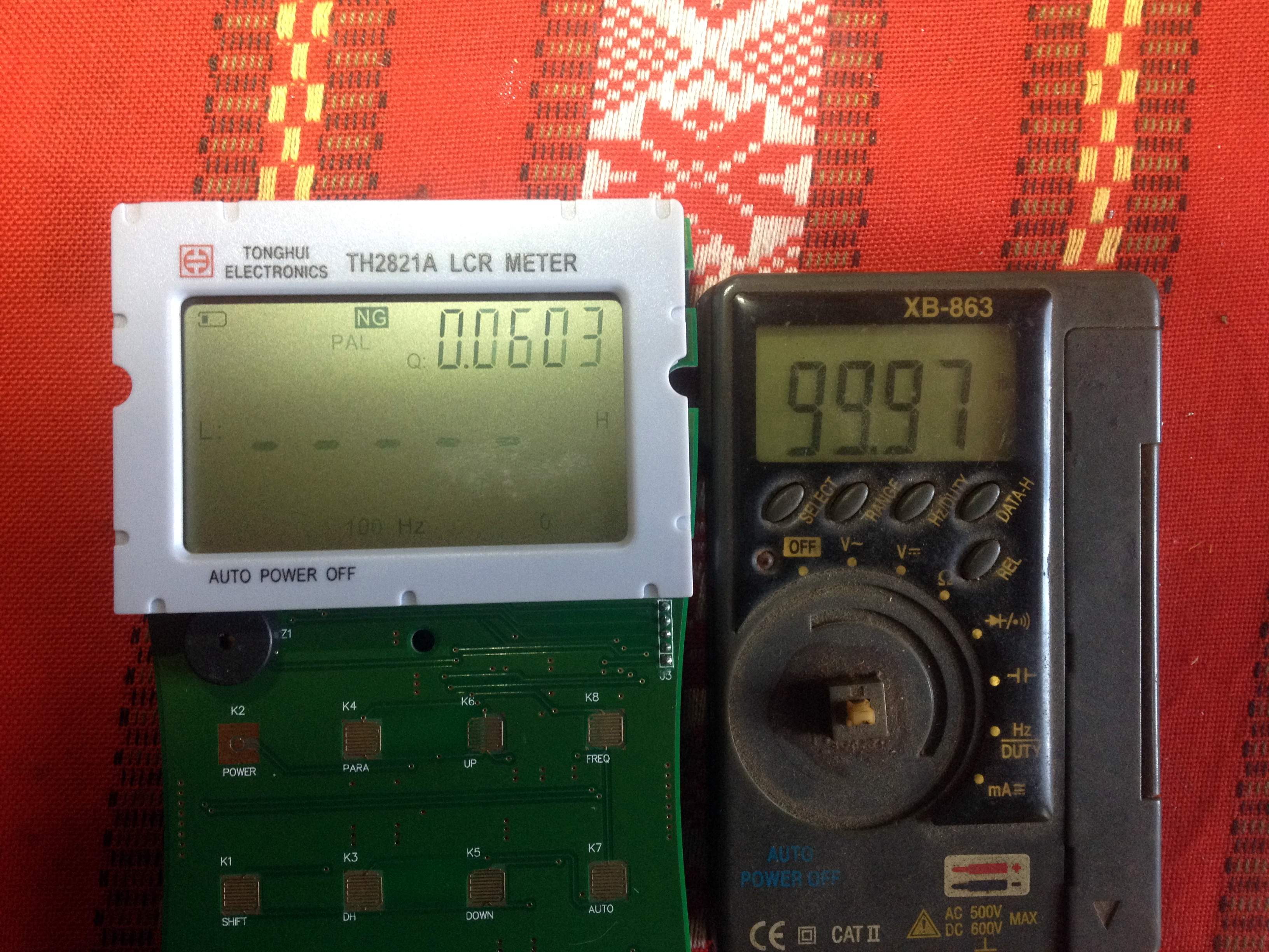

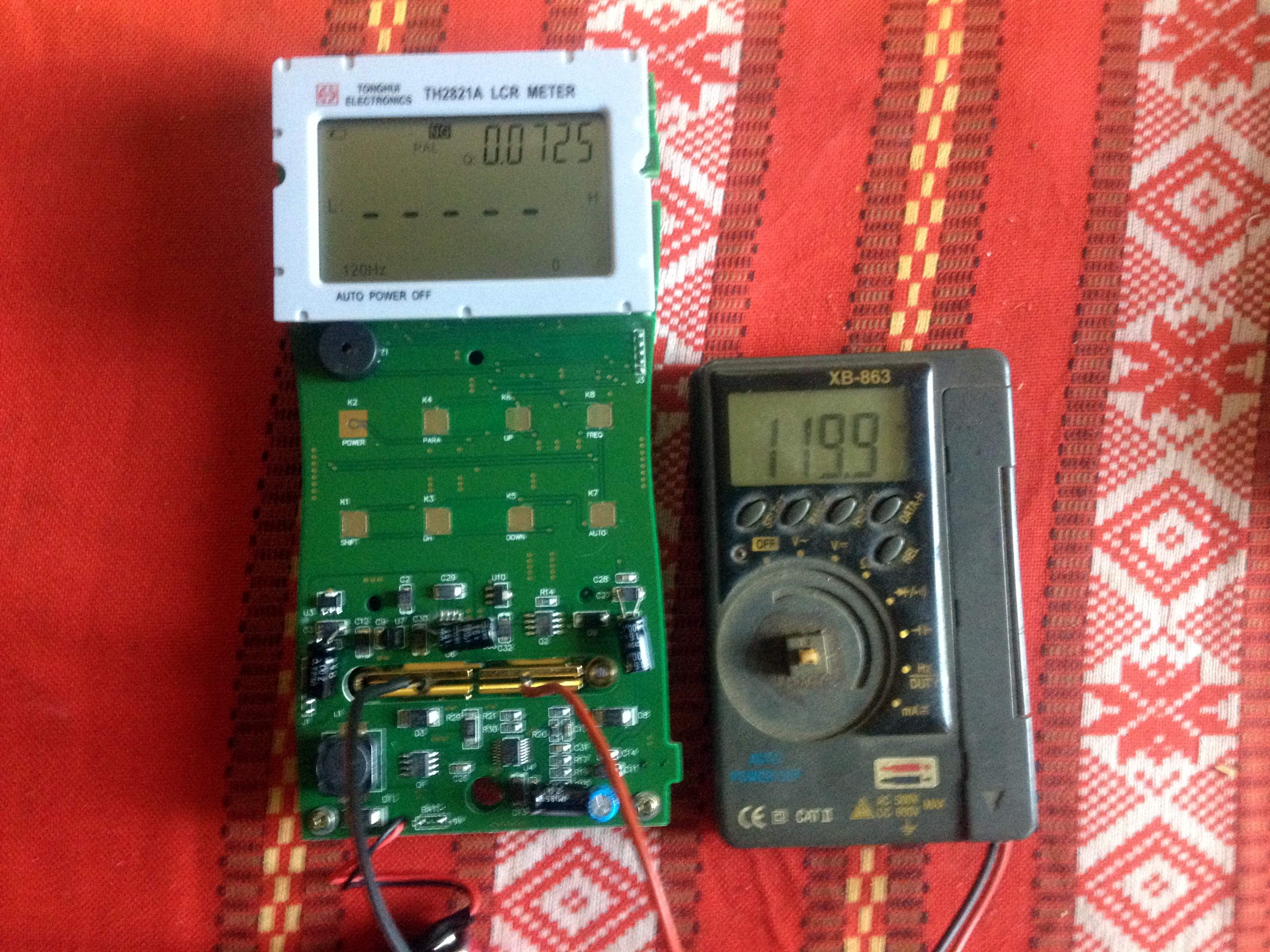

                  Most probably the fault is at "analogue" board. Lot of of cmos and opamps there.
                  There is also another thing; LCD contrast is weak.
                  And it dims a bit more when inductor is connected on socket.
                  Meaning further that something is wrong with power supply.
                  I checked rails; +5V and -5V are there, stable and correct.
                  3V3 also there, stable and correct.
                  What else...
                  Oh i wish i could use schematic now!
                    There is noticeable difference in LCD contrast with and without inductor in socket.
                    Observe the battery status symbol and how it changes contrast when i pull out the inductor from socket:
                    It must be related to power supply.
