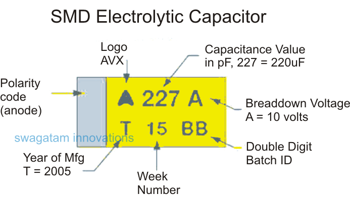

    226 = 22uF
    225 = 2,2uF
    106 = 10uF
    475 = 4,7uF
          for 12V you take C=16V. or D=20V, but D has more size, yeah??

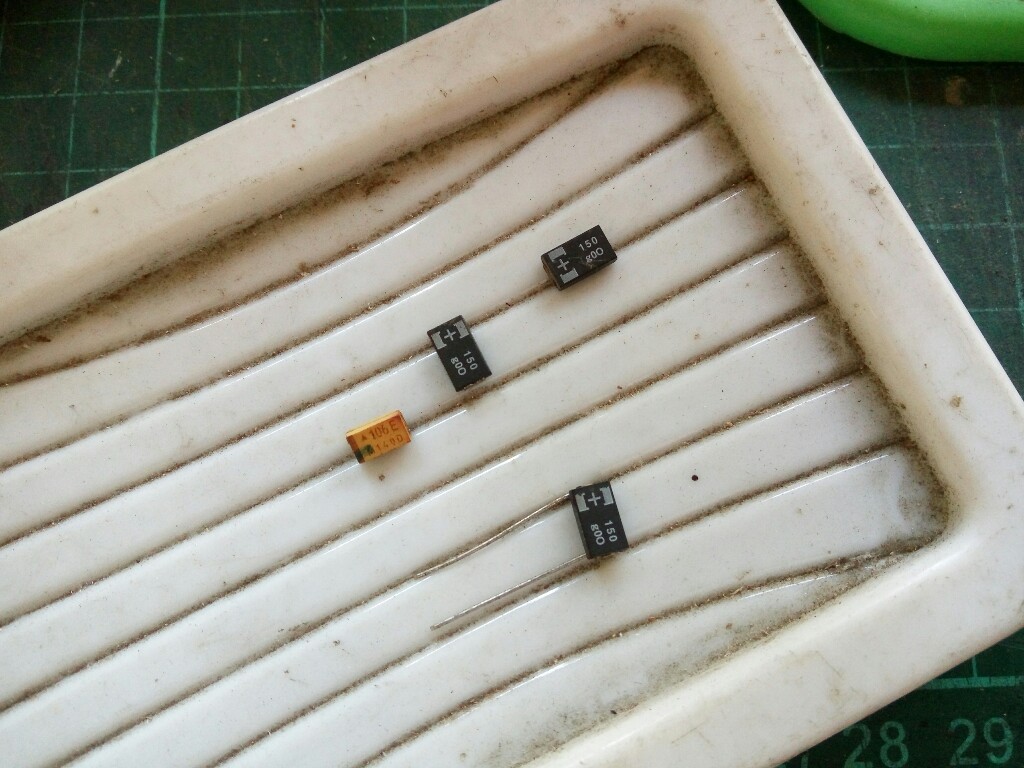

                        Tell me whats the V rating of these
                          [ATTACH]38336[/ATTACH]
                          do you look my post #5?
