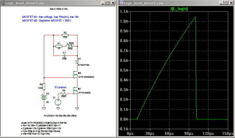

                    My design is a totally different approach: constant current drive and sampling during on-time by an IB coil. Best for maximizing both short and long decays (1us < Tau < 1ms).
                    The following is a traditional (not CC) driver adapted to 5v by use of a depletion type MOSFET, which considerably reduces the component count. A uC output pin can drive this directly.

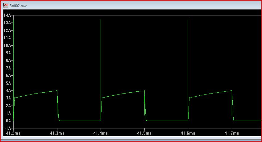

                          Its quite possible to effectively remove the time factor from the I = V/L * t equation above .... by recycling most of the coil energy its possible to get very large coil currents with a couple of volts .... 5 volts is almost overkill.
                          See attached ltspice :-) ... remove the .txt to use ltspice.
                          Coil current reaches approx 4 amps with 5 volt supply , 300uh , 1 ohm , 330 volt peak flyback and sampling under 10 us.
                          Last edited by moodz; 01-13-2017, 11:05 AM. Reason: this board logs u out while ur posting ;-(
                            Correction ...Coil current reaches approx 4 amps with A 3.3 volt supply ... 5 volts is too much

                              I'm not going to publish my PI circuit, but indeed I'm using an energy recovery scheme too. Something like the Vallon PI does but with a flat top for sampling on-time (Vallon causes a ramp top).
                                ....so you are sampling during TxON ;-) .... ...the current pulse rise time is fast enough ... but your pulse fall time looks a tad slow and overshot ...
