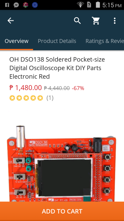

    Hello guys! Does anyone using this? Does it can do the job on calibrating diy pi like barracuda, surf pi and other simple pi?Click image for larger version

    it's a toy mostly, very noisy, but it can do a basic job.
      I have one. Get the DSO150 Same price does same stuff with a bit better on the Voltage scales. Handier to use. http://www.banggood.com/Orignal-JYE-...l?rmmds=search

        I built the surface mount version.
        Works fine with is single channel limit on a VLF. Works perfect for nulling a coil.
        Would be very easy to kill it working on a pulse though. Did set the offset on a Barracuda build with it though.
        On screen frequency and voltage measurements were spot on with my build when compared with a real oscilloscope.
        Great for testing sensors on vehicle
        Mine sometimes gets in a knot and I have to switch on with some buttons down and it resets itself.
        Not perfect. But useful, fun to build, takes up no space and portable as it runs of a battery
