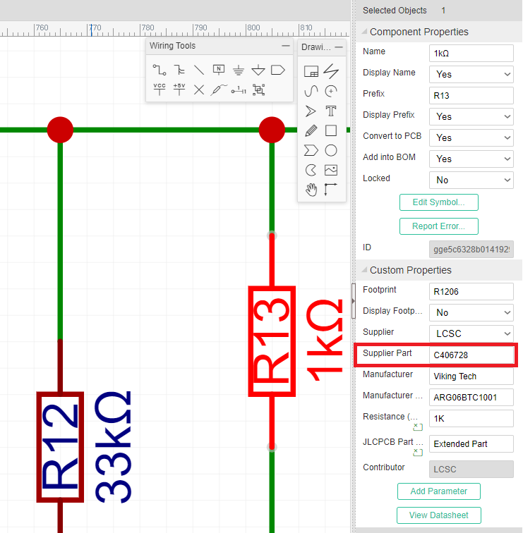

    I didn't know where else to post this so I'll post it here.
    If you can't find a part on EasyEDA, find a part with the same footprint and place it on the Schematic/PCB.
    After you've placed it, just replace the "Supplier part" number with the LCSC part number you want and press Enter.
    All other fields are ignored on the BOM tool.
    Click image for larger version  Name:	easyeda.png Views:	0 Size:	77.7 KB ID:	417558
    That's all you need to do and you're ready to order the parts from the BOM tool.
