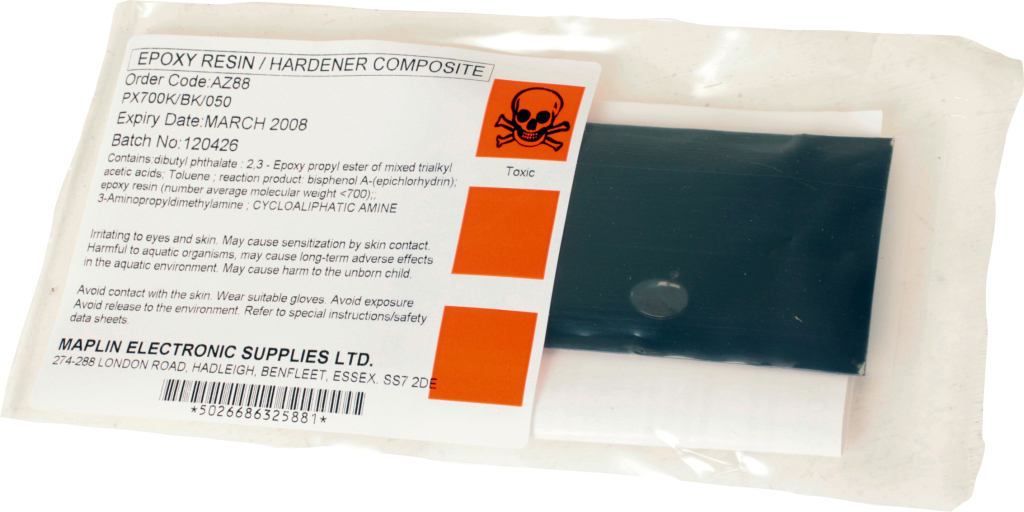

    What are people using for potting ,of electronic pcb,small.And for Coils,other than Foam,from a can?
    For Full Enviro sealing ,stability,etc,.
    other than expensive 2 pack resins.whats the cheapest,effective for Hobbiest
    to use. Thank!

    I heard of people using candle wax. It has good electrical properties, is water proof, light and not too expensive. The petroleum based one is best, sometimes it is called solid vaseline.

      You can buy potting compound from places like Maplin ->
      http://www.maplin.co.uk/module.aspx?moduleno=4057
        Gday Rov,
        The Epoxy Potting Compound is relatively cheap when purchased from the right places & i don't think you'll buy a better product for the application.
        Below is a 250grm pack for about $17, i normally buy larger quantities.
        If you buy it in the plastic bags the two parts are seperated by a divider, i normally cut the corners off the ends & pour the epoxy & the hardener into seperate tins. You can then mix small quantities as required seperately.
        It works out very cheap for each item, most times it's cheaper than lesser grade substitutes.
        http://australia.rs-online.com/mobil...duct&R=1991424
        http://australia.rs-online.com/mobil...94857722&Nty=1
          Yes,the first listed product in your links is very reasonable priced as well BC.
          especially from RS typically high prices.I think that will be the go.Thanks very much BC.

            Just watch your back... when using it...
            use gloves... don't touch the hardner stuff... mix and use... then let cure, but do not touch, do not inhale, do not smoke, use breather, work outside etc
            The thing... can give serious troubles and it's not joke... sensitized people can even die for a shock induced by epoxy compounds, expecially hardner.
            People here often forget there are risks involved in epoxy stuff... or just don't know about. It's toxic and can cause severe respiratory shock if things go wrong.
            Also... don't rub eyes , don't touch sensitive parts (e.g. mouth, nose etc) with gloves... use gloves then if have to rub eyes discard the gloves, rub the eyes, then use new gloves.
            Not a joke.
