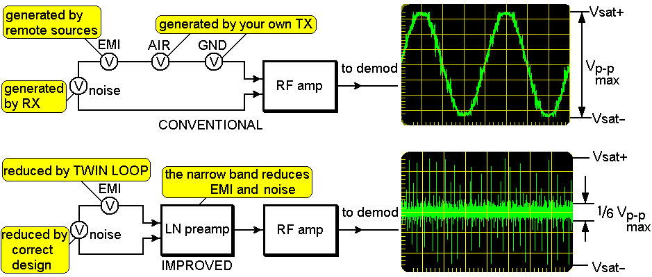

    1. Optimal power of TX
    Despite homebrew is not popular recently for hams, my hobby is to design TXs, RXs and antennas for QRP amateur radio.
    QRP means low TX power, maximal efficiency of TX circuit and exactly matched antenna. The RX for ham radio extracts faint signals masked by larger noise and interferences.
    The RX in a sensitive MD (metal detector) also should extract masked signals and sensitivity also should be limited by noise. However at conventional MDs this is not so (because they are not designed by radio amateurs:-).
    The TGT (target) signals at conventional MD are not so faint as in amateur radio, because they are not masked by noise and interference, but by AIR & GND - a signal combination generated by own TX.
    "Generated by own TX" means if we increase the power of TX twice, the TGT signal will increase twice, and the combination AIR & GND also will increase twice, ie the modulation index remains the same. This is very bad for incompetent designers, but ideal for my QRP concept. I can can reduce the power of TX until MD starts to loose sensitivity because there are interference and noise in input. In my concept, the TX should be low power and efficient, because it drains current from battery. The weight of metal detector depends on weight of battery. In a low power and efficient TX we can use more lightweight battery.
    So arises the question:
    "How to determine the optimal minimum power of TX for MD?"
    My answer is: "Maximal TX power is possible when there is ABC (automatic balance control) and AGC (automatic gain control). The ABC slowly try to compensate all signals in input of RX which have TX frequency. The AGC slowly try to increase the gain of RFA (radio frequency amplifier) to maximal allowed level. With correct operating ABC and AGC, we can reduce TX power until MD starts to loose sensitivity."
    Since this is said too summary and not so easy to understand, with following representation I will try to explain the concept comprehensively and more visually.
    The RFA should amplify received signal before demodulation with maximal possible gain. The possible gain of RFA is limited by signals in its imput without target. We can increase the gain of RFA until its output starts to saturate by undesired input signal. In the left side of attached image is shown the output when starts saturation by undesired AIR & GND signal in input. We should slight reduce this gain to avoid distortion.
    There are mine detectors and some honebrew projects of MDs which use two buttons for manual compensation (see BALANCE below) of AIR & GND in input of RFA. If ideal compensation is possible, the gain of RFA can be increased until its output starts to saturate by undesired EMI (interference) and noise in input. In the right side of attached image is shown visual effect at wideband RFA when output starts to saturate only by noise in input. Despite EMI is zero, this is not the ideal case. The ideal solution is a narrow band RFA to reduce the input noise, then we can increase the gain.
    Since depth of detecting depends on gain of RFA, every conventional metal detector should be improved with three buttons: two for BALANCE and one for GAIN as shown in other threads. However for best improvement should be used ABC and AGC instead manual controls.

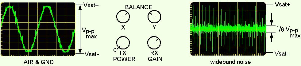

    If we upgrade with manual controls, what is the procedure for adjusting TX power?
    We should add a control TX POWER, imagine a potentiometer with switch to disable TX as shown below. What is the correct algorithm for adjusting control TX POWER?
    The first step of adjustment

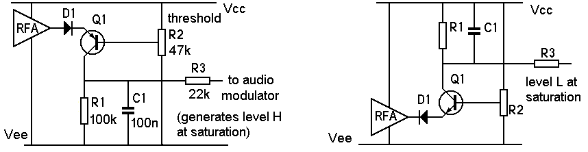

    FIRST STEP: Connect an oscope to output of RFA (or design a saturation alert circuit:-).
    The first thing we need for optimal adjustment of the TX power, is to have an alert or indicator for saturation of RFA output. This is necessary because we have a manual GAIN. (At AGC we have no saturation in output because the automatics so reduces the gain of RFA, that output voltage is always below saturation thresholds). At adjustments in the laboratory will connect an oscope to output of RFA to watch if there is distortion. However we search in the field with metal detector having manual GAIN control. We need to design visual and audible RFA saturation indicator.
    I have read several instructions for use of metal detectors, which have manual GAIN control of RFA. However I not found design, which has indicator for RFA saturation. Experiments are recommended in manuals how operator to understand that the GAIN is too high and that he must turn back the GAIN control, however, so he can not achieve an optimal setting.
    I think the sound alarm for saturation of the RFA is more useful than visual alert. So I designed a circuit diagram that triggered existing audio modulator in my detector. It creates level H at saturation of RFA output. If your audio modulator is triggering by level L of the control signal, you must change the type of transistor as shown below on the righthand circuit diagram.
      2. Disable TX and watch EMI
      2. Set TX POWER to zero.
      When TX is disabled, disappears AIR & GND signal, but remains EMI (interference) and noise. Now you can increase the gain of RFA to watch with oscope if EMI contains mains frequency and its harmonics.
      The GAIN control should be able to increase amplification until output starts to saturate with EMI. The attached circuit diagram is of an incompetent designed RFA, which amplifies all frequencies starting with DC. If the circuit of your RFA seems so, you should add a capacitor in series to R1. Remove R5 because it generates noise, and remove R3 because is useless.

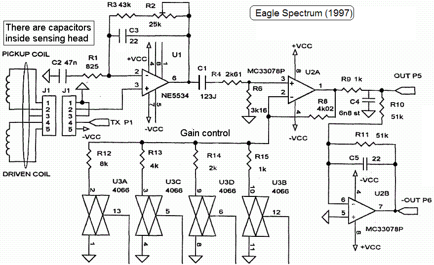

        For example Eagle Spectrum has manual GAIN control in 16 steps (realised with 4 electronic switches of U3 as shown below).

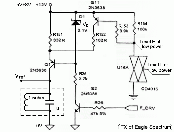

        It has also manual TX POWER control but in 2 steps only (realised with transistor Q11 used as switch). For precise power control you should connect a potentiometer 1kohm in series to R151 and disconnet R152. To disable TX, disconnect wire leading from pin 4 of J1 to rail TX P1.
        The oscope and SATURATION ALERT circuit should be connected to C4 (rail OUT 5).

          After you have TX disabled and connected an oscope to output of RFA, you see amplified EM interference containing mains frequency and its harmonics. However, surely you not see noise because EMI is more large.

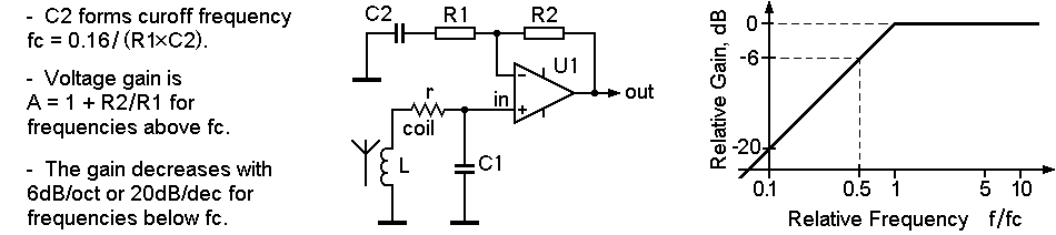

          A. Decrease amplification of EMI.
          If your RFA has an incompetent designed circuit diagram wich amplifies even DC (as shown in above), you should add a capacitor C2 (see the circuit attached here) to cut low frequencies. This also decreases thermal noise because narrows the amplified frequency band.
          How to calculate capacitance of C2?
          C2 forms cutoff frequency fc in spectral characteristic of gain, shown below as Bode plot. For calculation choose fc = (0.6 ... 0.7) f_tx. Then you can use the formula in attached image to calculate C2 at given R1. However in most projects R1 is not chosen correctly and it generates more noise than the resistance of RX coil. Often resistance of RX coil is choosen too low, which is useless but increases the weight of search head.

          Let calculate the maximal gain of RFA in Eagle (see above posting). The first stage with U1 has gain for noninverting input
          A1 = 1+(R2+R3)/R1 = 1+(12E3+43E3)/825 = 67.7 times or in decibels
          Av =36.6dB.
          The gain of second stage with U2A is maximal when are connected to COM all resistors R12||R13||R14||R15. This makes an equivalent resistance Re=533 ohm. Then the max gain of second stage is
          A2 = 1+R8/Re = 1+4020/533 = 8.54 times or in decibels 18.6 dB.
          Both stages amplify A1*A2 = 67.7*8.54 = 578 times or in decibels
          Av = 36.6+18.6 = 55.2dB.
          At suppressed EM interference you will see thermal noise because this is too high gain and you are not in the field (mountain:-) but in a room with oscope. For comparison , the RFA of a vintage "professional" metal detector in 80-ies C-Scope VLF.TR 1220B has gain only 9 times. This is preferable because its high TX frequency generates large GND signal.
          We can increase the gain of every preamp builded with opamp by decreasing resistance of R1. However the change of R1 leads to a phase shift. In Eagle Spectrum, the timeconstant T= R1*C2 = 825*47E-9 = 39us forms cutoff frequency fc = 0.16/T= 0.16/39E-6 = 4100Hz which is near to TX frequency 6500Hz . To avoid phase shift we should increase C2. If for example we decrease R1 twice, we should increase C2 twice. For Eagle this is R1=410ohm instead 825 ohm, and C2=100nF instead 47nF.
          Decreasing resistance of R1 decreases generated by it thermal noise.
          In ideal case when we have a noiseless opamp, for minimal noise we should choose R1< coil r. For Eagle the r of RX coil is 100 ohm and should choose R1<100ohm. However we have a noisy IC NE5534 which generates noise density 4nV/rtHz as a 1000 ohm resistor.
          We can choose R1 near to 1/5 of virtual "noise resistance" NE5534, ie 200 ohm without significant incresing thermal noise in input. Then no need of RX coil having so low resistance. If we design a RX coil suitable by noise for preamp with 5534, we can reduce the weight of winding by calculating so wire diameter that to achieve coil resistance 200 ohm. Then we can use R1=200 ohm and both resistances should not contribute significant to total thermal noise.

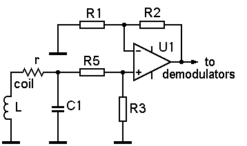

          Here is the algorithm for front end design giving minimal weight of RX winding and optimal low noise.
          1. Transform noise density from datasheet of used IC in resistance of a noise generating resistor Rn. I have posted in the forum a table for this purpose. Table shows that NE5534 is noisy as 1000 ohm resistor.
          2. Choose RX coil resistance Rn/8 < r < Rn/2. For NE5534 this means 125 < r < 500. Since I use TWIN LOOP, each RX coil is 180 ohm which means total r coil = 360 ohm.
          3. Choose R1 < coil r. Since NE5534 is too noisy, this rule is not so important. I choosed R1= 390 ohm, ie my R1 > coil and despite this is not optimal, it is used in every conventional metal detector (ecause there is AIR & GND signal).
          In next step we will reduce the AIR & GND signal.
            Another way to summarize some of these ideas is to say that "signal-to-noise" is the real factor we want to maximize. This means you need to do a good noise analysis to understand thoroughly the noise you are dealing with, and it also follows that adding power is not useful unless it improves the signal-to-noise ratio, and it makes sense to reduce power as long as the signal-to-noise does not suffer.
            Also, if you find you can take advantage of more gain in the RFA (I wish), but the "null" signal is limiting the gain because of saturating the input, do you consider canceling the null electronically? I think you call the null signal the "air signal".

                    Here is the complete circuit of TX:
                    http://www.geotech1.com/forums/showt...eferrerid=2910
                    See posting #6 in that thread.
                    For manual adjustable power of TX, replace R9 with potentiometer named "TX POWER".
