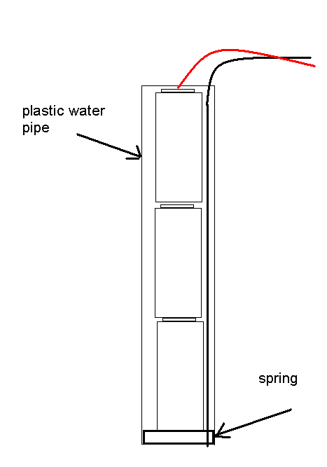

        i've done this with odd size batteries
        it can go inside the metal detector stem or clipped on with bike pump holders
          hello taliesin,
          i made it his way for bicycle flashlight. Good trick is to connect the batteries with thin neodym magnets (dia 8mm strenght 2mm).
            nice
            i'll try the magnets
