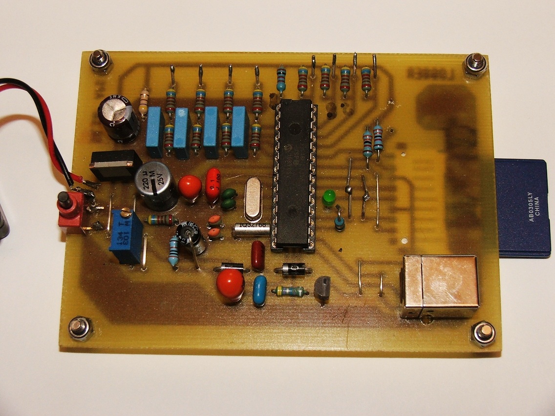

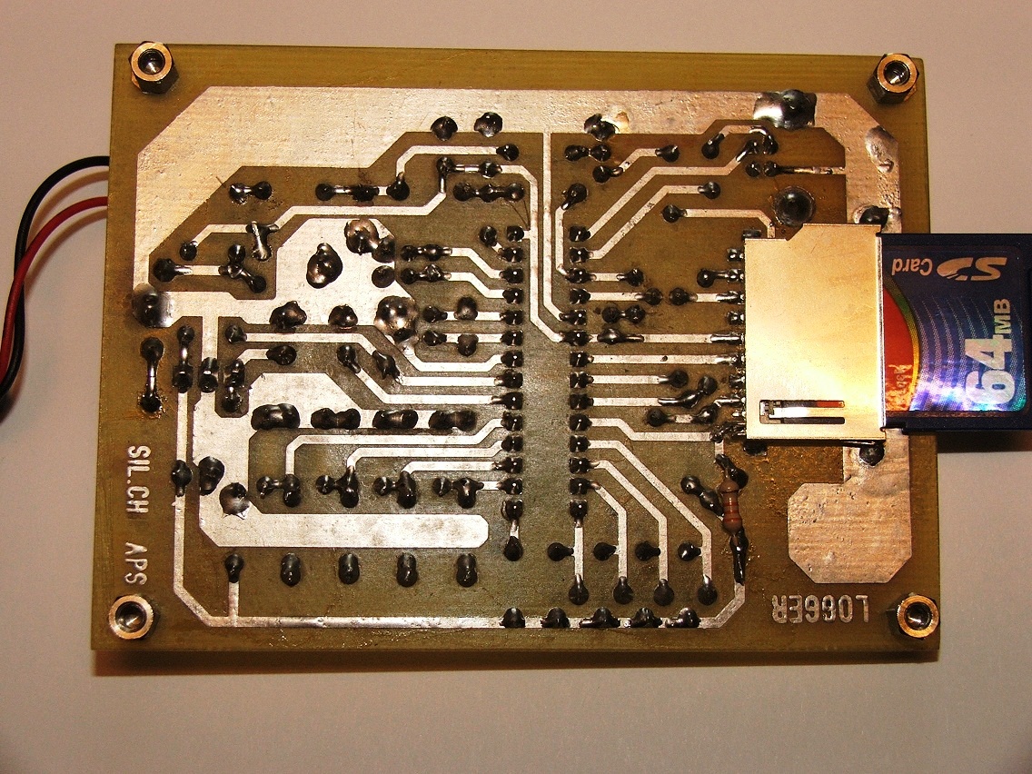

    Hello 6666 ,
    Thanks for the info !!
    Now I know way it is hard to get a pcb... sad ...
    Some time ago I have send a mail to Altronics, they have send then me a friendly mail that at that moment no kit was on stock..Some week ago have mailed them again,not yet a answer...
    See the pcb that I made from the schematic that was in the Silicon chip mag, hope no errors in it..
    Smd is new for me so I hope that I have connected the SD card holder in the correct way ..
    Think that is a very nice logger.... if I can get it to work.

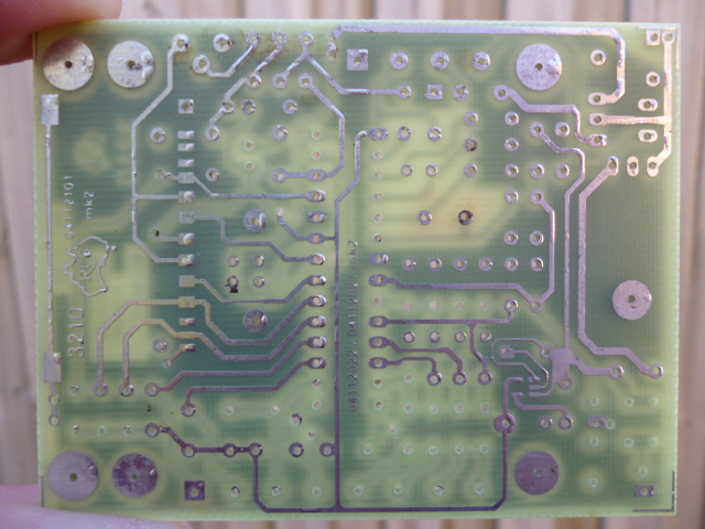

                  Hi AP
                  I have some news for you
                  first the kits at altronics are months from being delivered if they get them at all
                  But I have finally got on to the people who can make the PCB
                  they are Australian $30.25
                  plus postage to me is $4.40
                  PLUS postage to you, this is unknown untill I take it to the post office, maybe ~$8.00 airmail.
                  Now I have to send them a cheque, in the mail, and If they have it in stock
                  they will send it on the friday of that week, after my check clears.
                  If they do not have it in stock they will make the PCB, and send it to me on the friday of that week, after my cheque clears at the bank, so there is some possible delay.
                  Friday is their posting day
                  What would you like me to do ?
                  cheers 6666
                    Hello ,
                    Sure, I like to have a pcb from the original design....then I can compare it with the one I made after the schematic that was in Silicon Chip. The layout from the original pcb was never in the magazine...
                    Thanks for getting the info ! Going to send you a PM.

                      Hi AP
                      still waiting for the pcb to arrive
                        AP your pcb has arrived please check your email
                        6666
                          6666
                          Hello 6666,
                          Have received the pcb !
                          Thanks very much, great action from you !
                          Best regards.
                          Ap
