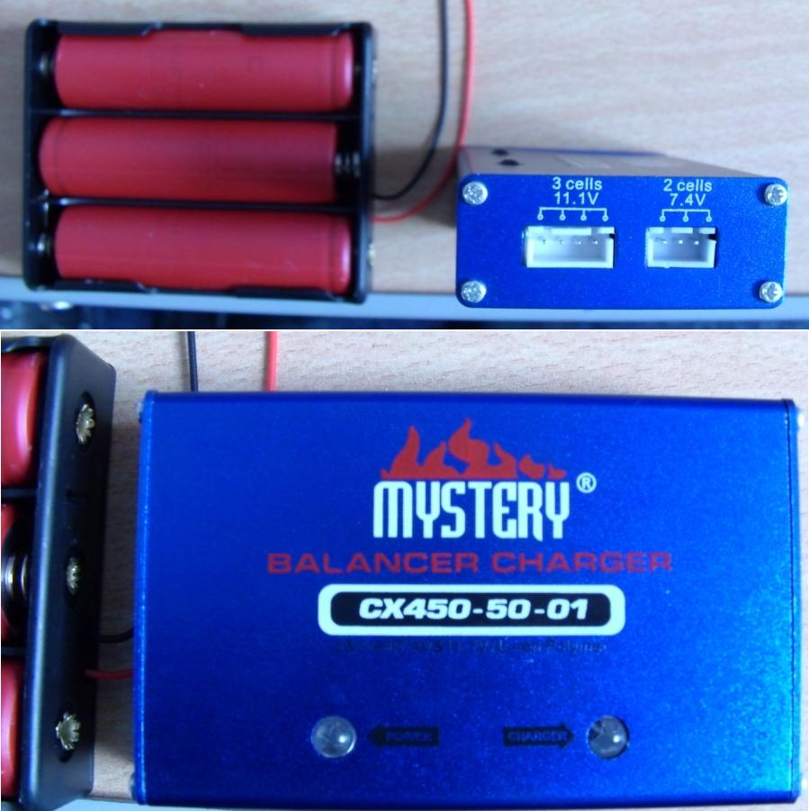

    hello
    how can i connect this balancer charger to 18650 pack
    it are 3 cells in serie the holder has one plus and one minus cable
    the connector on charger has four pins
    has that connector a name?
    regards bernd

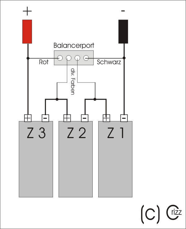

    helo again
    found something, maybe this way
    its a xh balancer charger plug?
    greetings bernd

            You have 4 pins for the balance charger.
            3 individual positives, one for each cell.
            1 ground to be used for all cells
            You can solder additional wires into your battery pack to plug into the balance port.
            You also have a balance plug for a "2S" (2cell) pack that is similar, 2 positives, 1 ground for both cells.
            This is how the charger controls the charge rate of each individual cell.

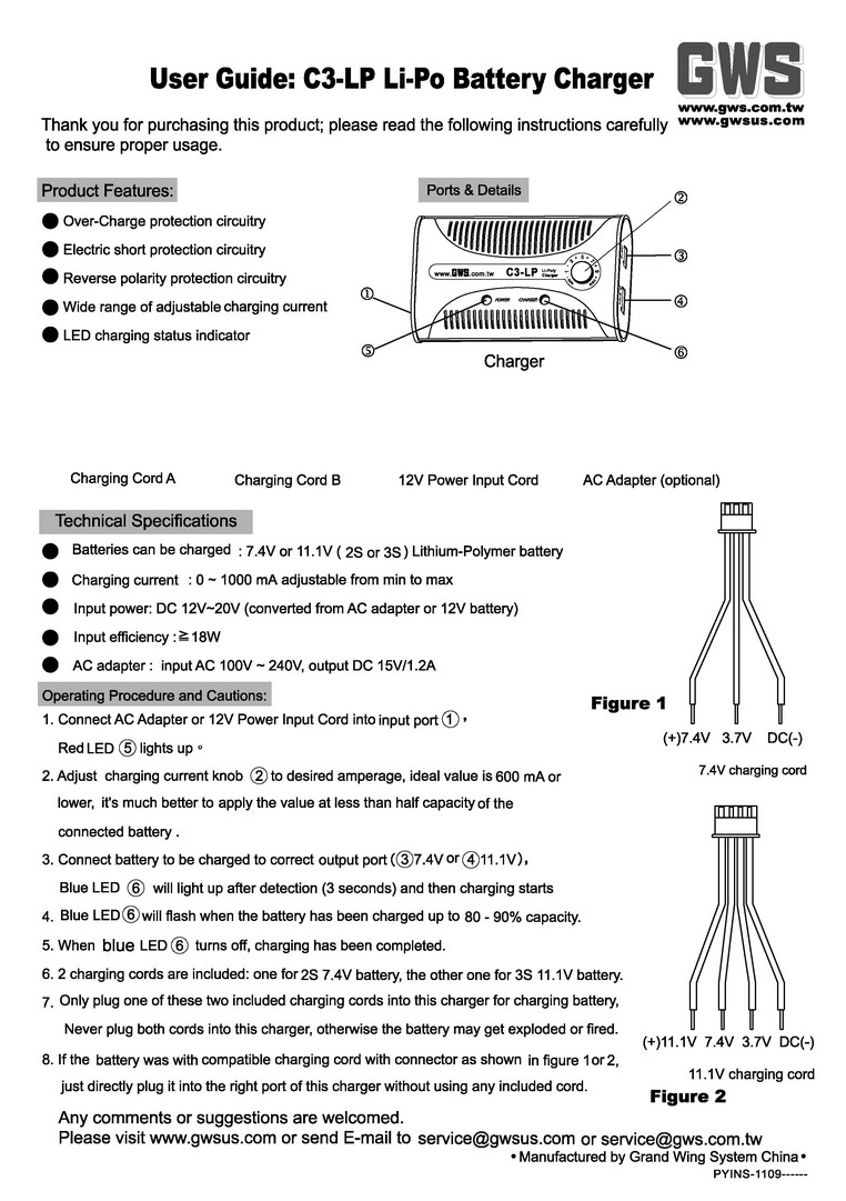

              This may give you a clue
              http://www.gwsus.com/images/note%20book/e_c3lp.jpg

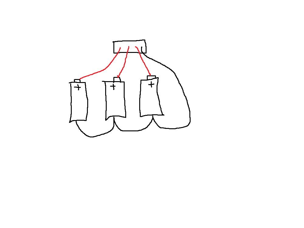

                No that is wrong, read my reply.
                The one negative goes to all negative terminals parallel.
                Each battery gets its own individual charge lead. (positive)
                  Like this,

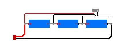

                          Originally posted by UFO View Post
                          Like this,
                          THIS IS WRONG
                          If you measure between the first and last pins of the balance plug on a LiPo you'll get the full rated voltage. If you keep the ground probe on the ground pin, and move the positive probe across the pins on the balance plug, the voltage will increase by about 4.2V per cell when the LiPo is fully charged.
                          THE WIRING DIAGRAM YOU HAVE PROVIDED IS FLAT OUT WRONG AND DANGEROUS FOR A LIPO CHARGER.
                          In your wiring diagram, measuring the voltage on the first and last pins would only read the voltage of a single cell.
                          The other diagrams provided are correct.
                          This is not a balance charger and the schematic is wrong. Not trying to be a ****, but these suckers will really burn if miss-treated.
                          That is a balancing charger for LiPo batteries, any charger that uses the 4 pin and 3 pin balancing plugs are balancing chargers. Normal high speed chargers have a positive and negative that connect to the main terminals of the battery.
