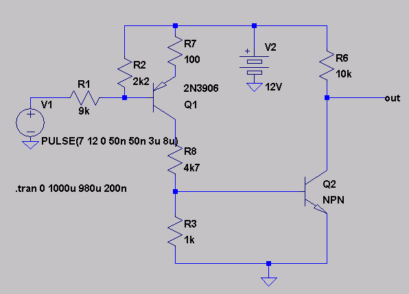

    Attached is a level shifter circuit. This works OK for a pulse width of 5us and more, but there is some propagation delay. The switching speed is also affected by the output voltage, in this case the battery charge level.
    Using HF transistors makes the switching faster for pulses of 1us.
    I am looking for a better solution, less propagation delay, better accuracy, faster switching.
    Any suggestions?

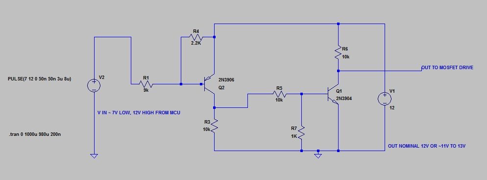

    Keep the PNP linear.
      Yes, a bit of emitter degeneration does the trick. Delays happen when transistor goes elsewhere from saturation. You may observe it as spikes in base current. Degeneration helps.

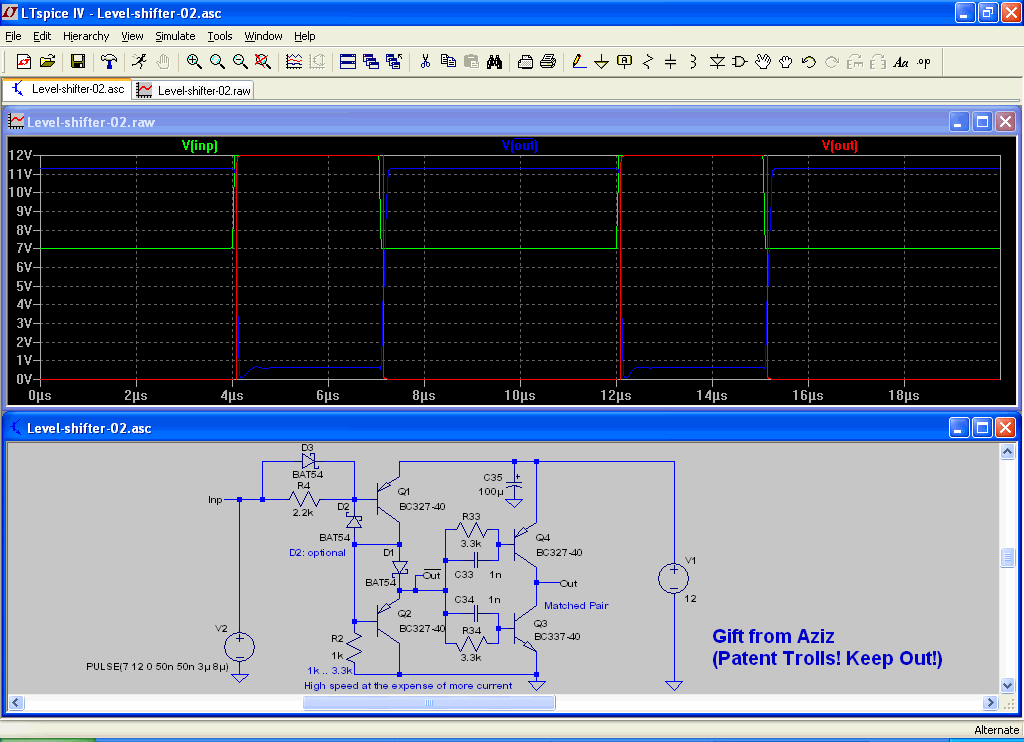

      I made some minor differences to your schematic, not to ruin your concept. Enjoy
        What about this one?
        (Who dares to optimize it further?)
        Aziz
        PS: The output doesn't need a mosfet driver! It has the driver built-in.

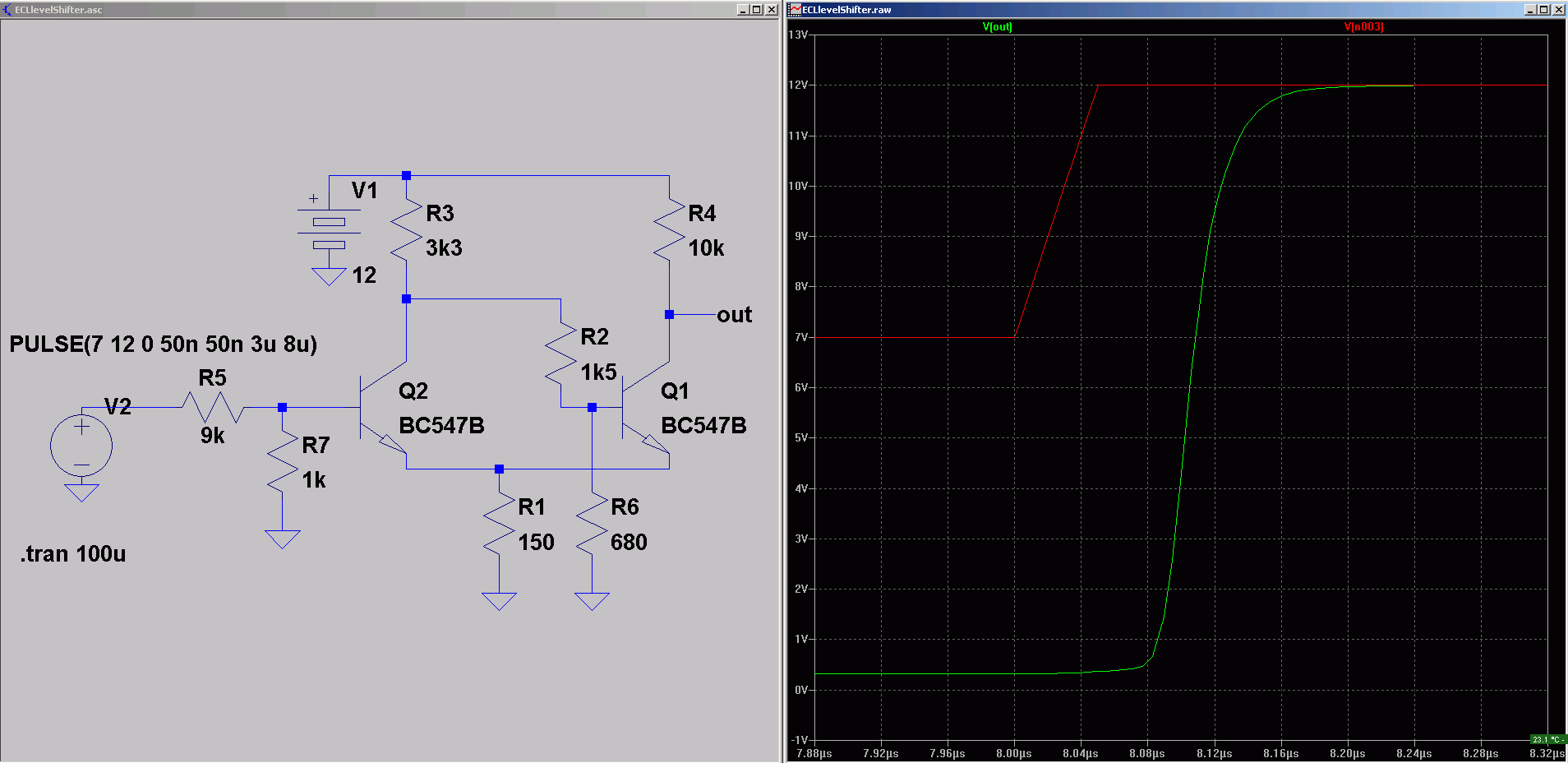

          I played a bit with ECL Schmitt trigger and it is now just some 20ns slower that yours, yet there are no nasty transients in transitions, and power consumption is just right

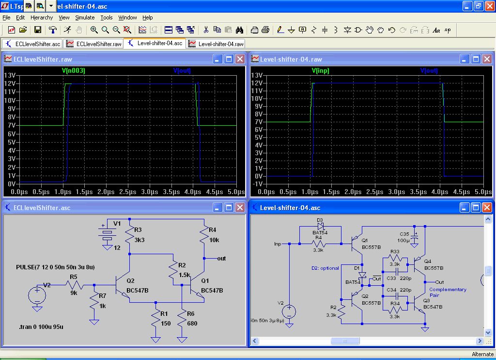

              Slight modification (other transistor) improves the level shifter + mosfet-driver + power consumption:

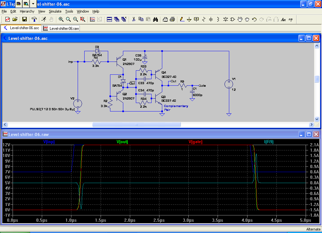

                        No problem with the right complementary pair transistor stage (see below). Generally, a mosfet based mosfet-driver (complete IC) is more convenient of course (low power, low impedance, fast switching, high load drive capability).
                        So use the ECL driver above and feed it to the mosfet-driver IC. I personally like the ECL driver more than my proposal.
                        Cheers,
                        Aziz

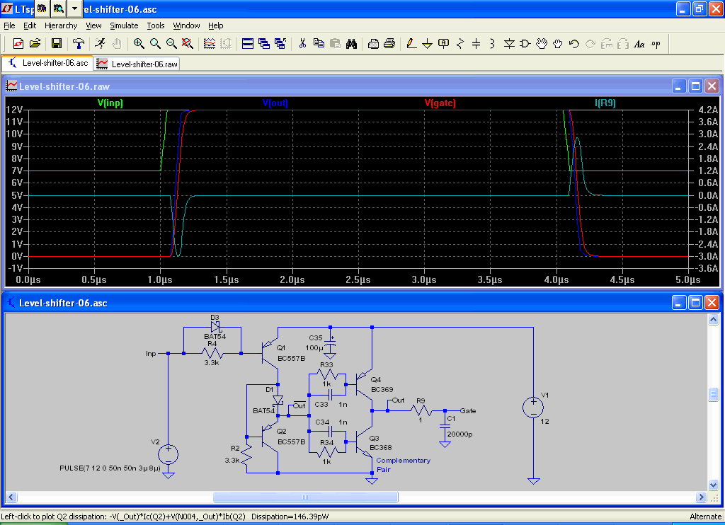

                        PS: The 2N2907 seems to be slower than the BC557-B.
                          More Drive Capability with BC368/BC369
                          Hi all,
                          if you need more drive capability, use the complementary transistor pair BC368/BC369. It delivers enough power for our purpose. Notice, I have a 20 nF load capacitance this time.
