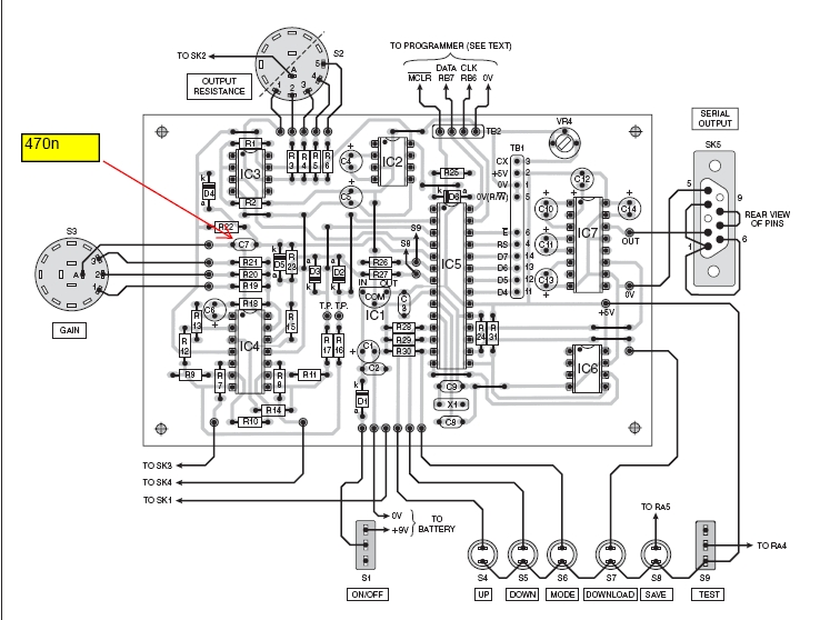

        Yes i had tried the same code, so my conclusion is that it may be something wrong with components, so i ll check it out to see where is the error. The circuit runs 80%, but it lack when you turn it on and when push commands, always doing things with delays between 6 to 10 seconds. Don´t know what is realy happening, my electronics knolegment is very poor to identify the fail. The only think i know is that C7 (470n) is rated for 100 volst or more, so don´t know if this really maters.
        Do you know what can be the cause.
