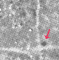

        To place treasure chest 5m undergroud pirates had to dig very big pit-hole.
        Hole was after filled again with soil normally more damp and humic relatively to surrounding undisturbed soil.
        More damp also means less resistance to current..
        Resistivity meters measure the those differences in electrical resistivity of soil.
        Readings should be taken on a grid covering the whole site you think treasure is.
        Results (varying resistances) should be then plotted acording to grid used on site.
        Posted picture shows one such plotted result (40x40m) with feature resembling one bigger hole in one corner of linear features - ancient parcelization.

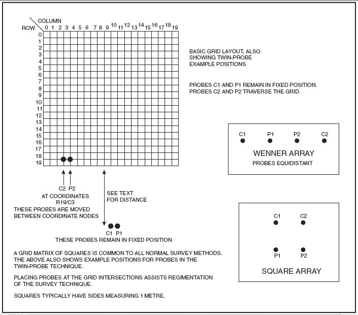

            There are some way for the probes arrange.But I don't know which one is better for tresure hunting.
            My desired target is about 20cm x 20cm, and I don't know how deep it is.(1m...5m)
            - Is twin-probe the best choice?
            - What distance should be between the probes?(C2,P2)
            _ What distance should be between the probes(C1,P1) and the matrix?

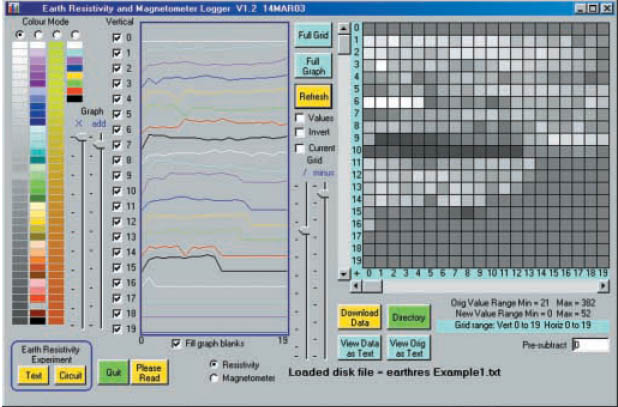

              Here is the my logger view:

                The arrangement you are using is a good one, but is good for around the distance of the twin probe setup you are moving through the grid. So if the distance is 3 ft then you are seeing down to about 2.5ft in depth. If you are to see deeper you would have to widen the probes.
                  Can you send me the data from your logger my software will show more detail if I can convert it.
                    Here is the data:
                    earthres 1.txt
                      Wow thats some data. Does your software have an export option? If so export the data in xyz format. If not tell me what was the grid size of the data file you sent.
                      Tim
