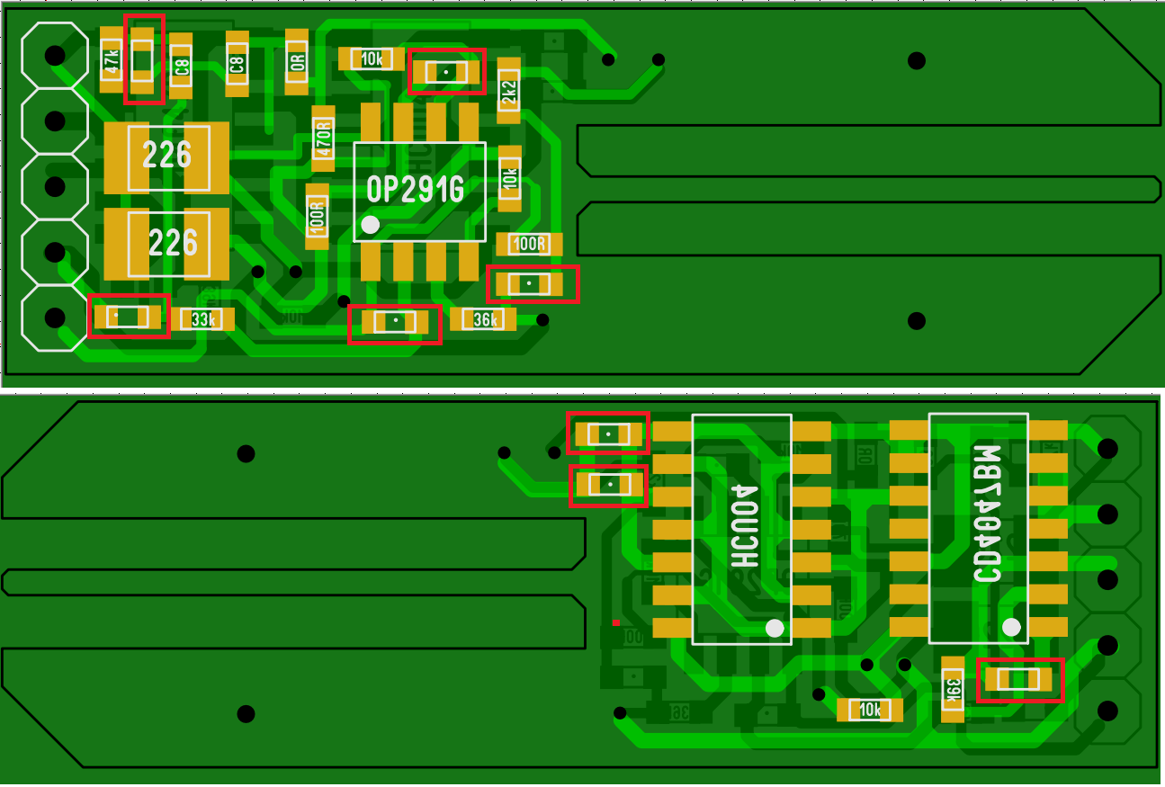

          I have found a .lay files for flc 100 and compare schematic and lay files. Its not same. Can someone has this correct scmeatic or .lay file ?
            Is it possible to use bas46 or 1n5819?
              Your schematic file and layout file are the same
              Just connect the ref to the positive of left 22uf capacitor

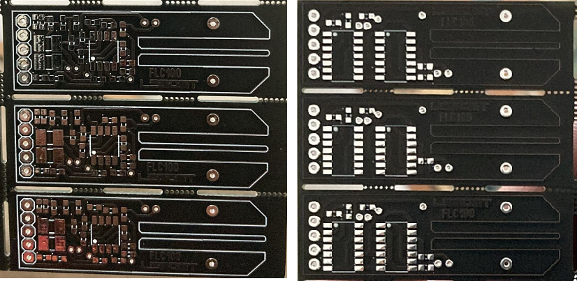

                    Hello I have created pcb and want to assemle it. But I have to find only capacitor values. Can someone who know help to me please ?
                    These are my pcbs from jlcpcb
