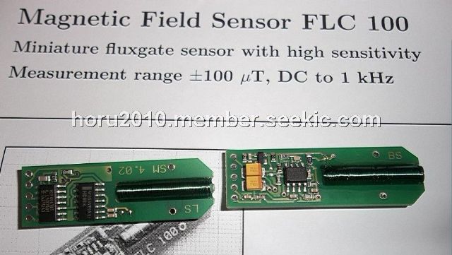

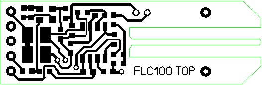

              Hi Friends Who sensor schematic flc 100
Name:	senzor flc gornja pcb.jpg
                    [ATTACH]25505[/ATTACH]
                    Hi Friend Who sensor schematic flc 100
                      Hi everyone, I mean the way flc100 sensor schematic teachers who were
                        Help me?
                        Can you shared al files? lay and up, down pcb pictures?
