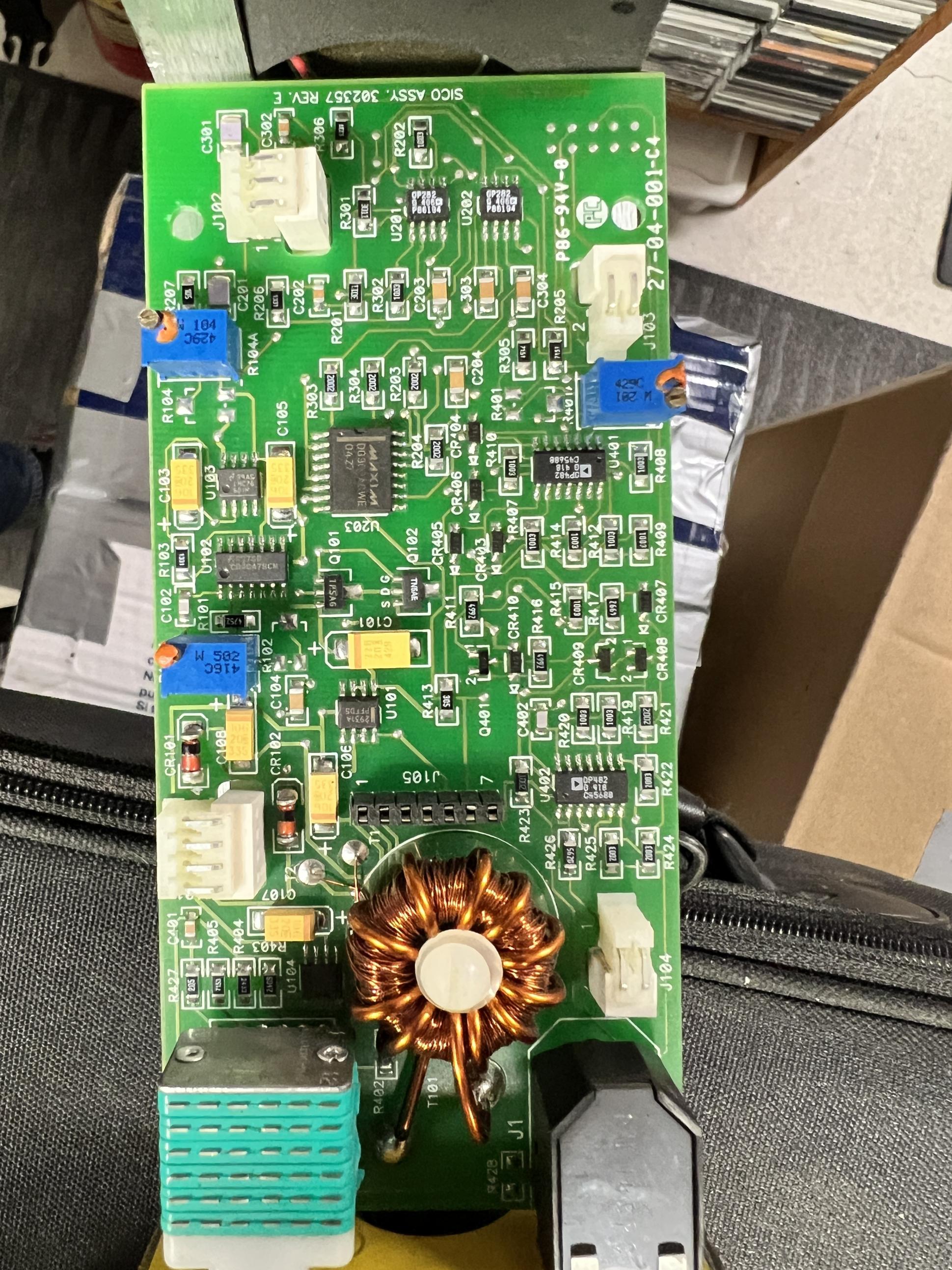

ID:	429714 I just received another GA-52cx. It seems a bit “off” from another one I have. The general sensitivity as I go through the sensitivity switch settings seems a little less than the other one and the tone pitch is not the same - but close. This and it has some FM going on that isn’t desired. There are 3 trimpots - two of them have been played with by the previous owner. The third is sealed in place.
        Any ideas on a calibration process?
        Would it be something that would not require special equipment?

            Ok, given that, what would you guess each of the 3 trimpots do and how would you go about optimising operation? I like your earlier suggestion of trimpot names but away from a target the tone and sensitivity is like the other one I have. Should I be moving a small target up and down the shaft and adjusting something like a differential gain?

                Thanks for posting this video. I have a very old GA-52 and wanted to remove the sensors from the tube . I have hesitated up to now, not wanting to damage or destroy anything.
                Have you tried contacting their service department? Some times a tech will give some good info without sending the unit in.
                  If it were mine I’d spray some of that bolt-loosener stuff and let it sit awhile before trying this. That volume control he’s hitting with the hammer is $42 plus shipping.
                  There is a “talk to our techs” option on their website. I left an inquiry.
                  There are several businesses and individuals that work on these. It’s all kept secret on how…
