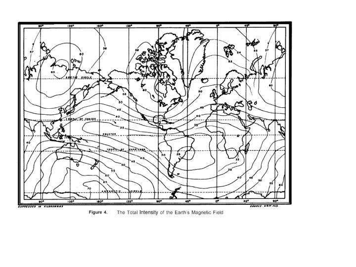

          The precession frequency in your region is 1916Hz and NOT 1600Hz.

              sir plz confirm again the precession frequency in our region.is it 1916hz.how u have calculated.
                Re: Sensor ...
                plz again explain the procedure for the sensors using spectral lab program.tell us about the RMS values of the sine wave in detail.
                  Re: Sensor ...
                  From this map graduated in xx,000 Gammas.
                  Willy
