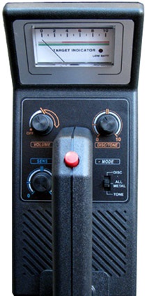

    I have a 20% coupon for Harbor Freight and could get their 9 Function metal detector shipped for only $43. I figured it would be a fun project to experiment with for a such a low price. It seems in the last few years quality has improved, and there are many great reviews in the last 3 years for it. I'm not sure but it appears to be nearly identical to the old Radio Shack Micronta detectors too.
    I was curious if anyone knew the frequency of the HF detector coil?
    A common post I have read online are that the Bounty Hunter detectors operate at the same frequency as the ones made in China, such as the Harbor Freight model. So I wanted to know do they use the same frequency or close enough to use the coils? As I know some of the Bounty Hunters/Teknetics can use the same coils, but do vary in frequency a bit.
    It wouldn't be much effort to add a 5-Pin DIN 240 Degree plug and socket to the Harbor Freight detector so it could use the Bounty Hunter coils - and make it a much more useful detector.

              After much digging online it appears the Harbor Freight 9 function detector is 5.8khz, thanks to ultralightpilot for testing.

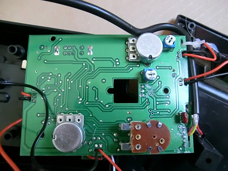

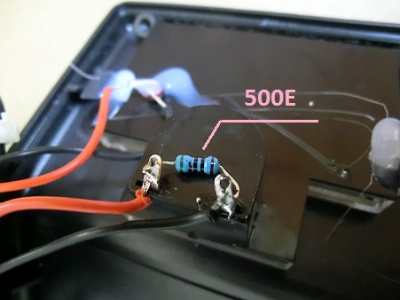

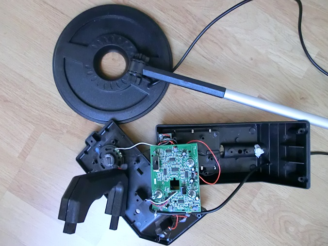

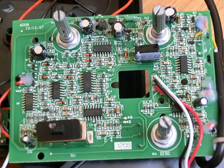

              Factory name of those "9 Function" detector is MD6008.
              Working frequency is 5.95kHz (exactly).
              For banging meter pointer can help to put resistor (of about) 500 Ohms in parallel with meter contacts.
              Here some pics:

              Mine can detect 1 Euro coin at 21cm in highly mineralised testing substrate in Tone mode (Sens max), 30mm silver coin at 20cm, 15mm 1.1gram gold pendant at 13cm and gold nugget of 1.1gram at 7cm which is excellent. Tested with factory 8" coil.
              Surprisingly it is not deeper in All Metal mode as expected (for comparisons: it can detect mentioned gold nugget in All Metal mode at 5cm).
              Tone identification between Ferro-objects and noble metal targets (like silver) works well, but sound of noble metal could be set higher, to be more enjoyable and more distinctive.
                Thanks for the informative post and images - especially about the resistor. I have some 560 Ohm resistors handy so I'll try one out.

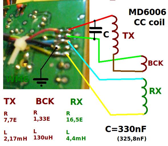

                  Yes, I have and tested model 6006 too. Here you can find its coil data (if one is interested to build it):
ID:	335476 Click image for larger version
                  Measured frequency 5.975kHz. Considering its 16cm coil, results are not much worse than those of model 6008. In difference to model 6008, model 6006 it is coming without dual tone identification.

                          I tried adding the 500 Ohm resistor (Actually 470 Ohms plus 33 ohms) Across the meter, and while it did keep the meter from pegging out, it still goes to the same place every time, just not to the end. it's like the meter is connected to a digital On/Off gate instead of an analog
                          signal.
                          Would be interesting if we could get someone who has a Scope to see what is going to the meter, with different metals at different distances from the coil
                            signal.
                            I know, resistor is not an ideal solution, it help mostly to keep meter pointer not to bump to end of meter scale on every signal. In my case difference between week target signal and strongest target signal is of about 1:3 in pointer movement and this satisfied me for now.
                            At this point I am not very motivated to do some reverse engineering to get 6008 audio stage/line schematic, but I do not exclude this option for the future.
