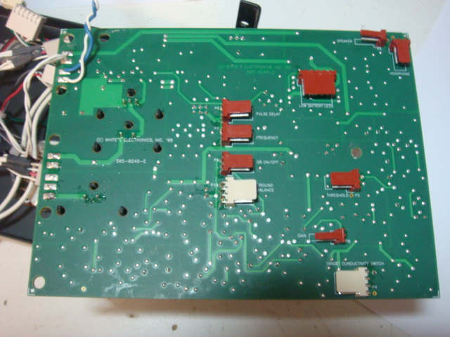

      Hi Henrik,
      Maybe you could remove the box from the stem. Surely it would be cheaper for you to send just the control box.
      Have you tested performance on your gold ring with GB off / Target Conductivity all ? Be interesting to see.
      With a brand new detector, the last thing anyone would want to do is open it up. But with you so far away from your supplier or Whites workshop, it is understandable that you are keen to see if there is a simple fix.
      With the more recent versions of the TDI family, some of the controls are connected to the pcb via top mounted fittings. Though I have no idea whether your Power off connections are on the top or bottom of pcb. Or if it is soldered or a connector.
      Here is a photo I found on the internet of the bottom of a TDI (Pro).
      The latest SL variant appears to have connections on the top. (and possible future features like Grab and GB Auto/Lock ! There are unpopulated connections for those. )

                If I recall, the TDI Pro uses the same PCB as the TDI SL. (I should know since I designed them both, but I just don't recall.) The 'Pro on/off switch controls a FET switch, so it could be that the FET switch is shorted out and won't turn off.
                  Thanks Carl.... One good reason to use the warranty.
