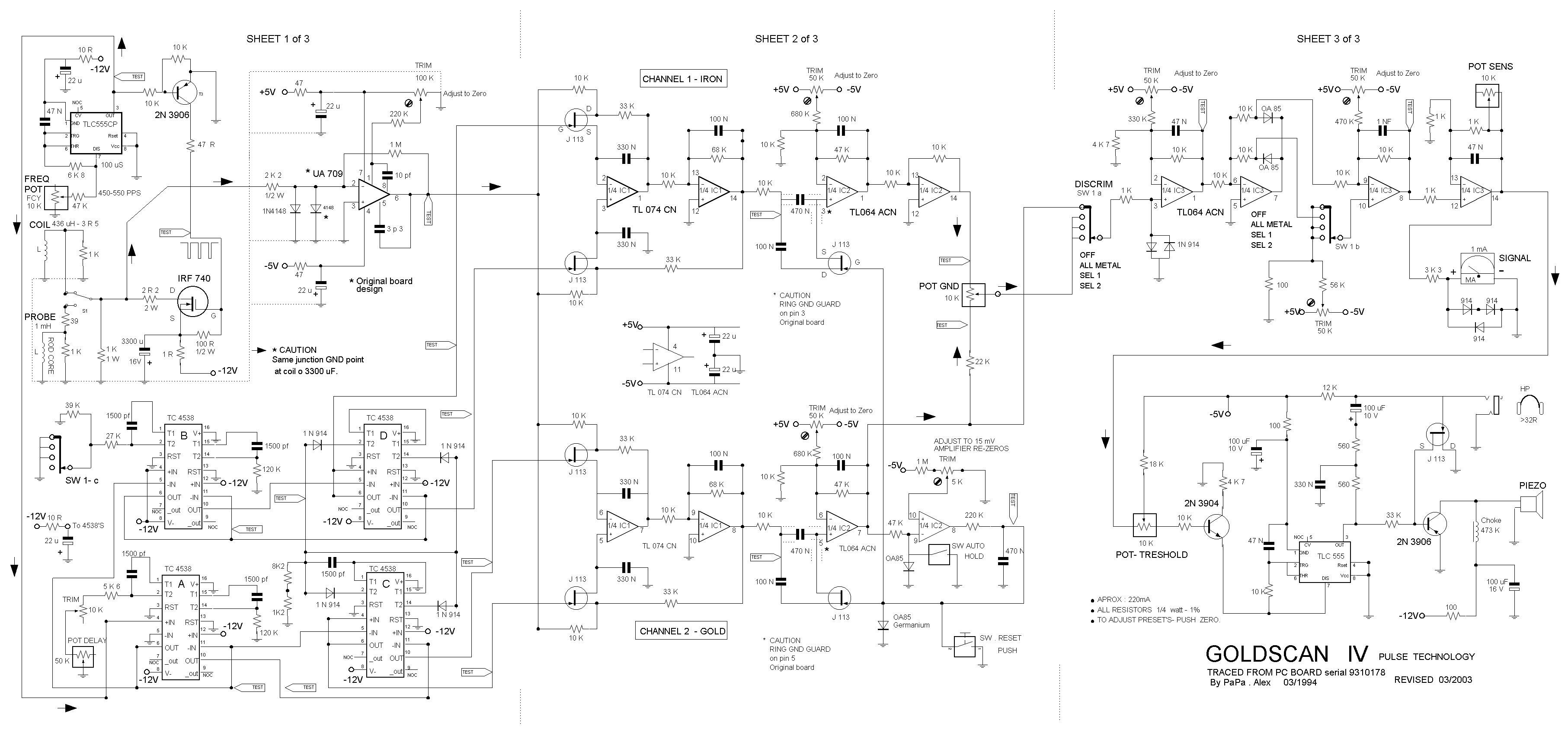

                        hi mate sorry for the late reply, the goldscan4
                        I think it was this one, I used a digital meter instead but works just the same.
                        aly.
                        p.s, when you first open the gif it looks crap, but its fine if you zoom in, as a matter of fact there is a vco audio block on that scheme that can be re-used too.

                          thanks that schematic seems to have more information on it that I've noticed before cheers
