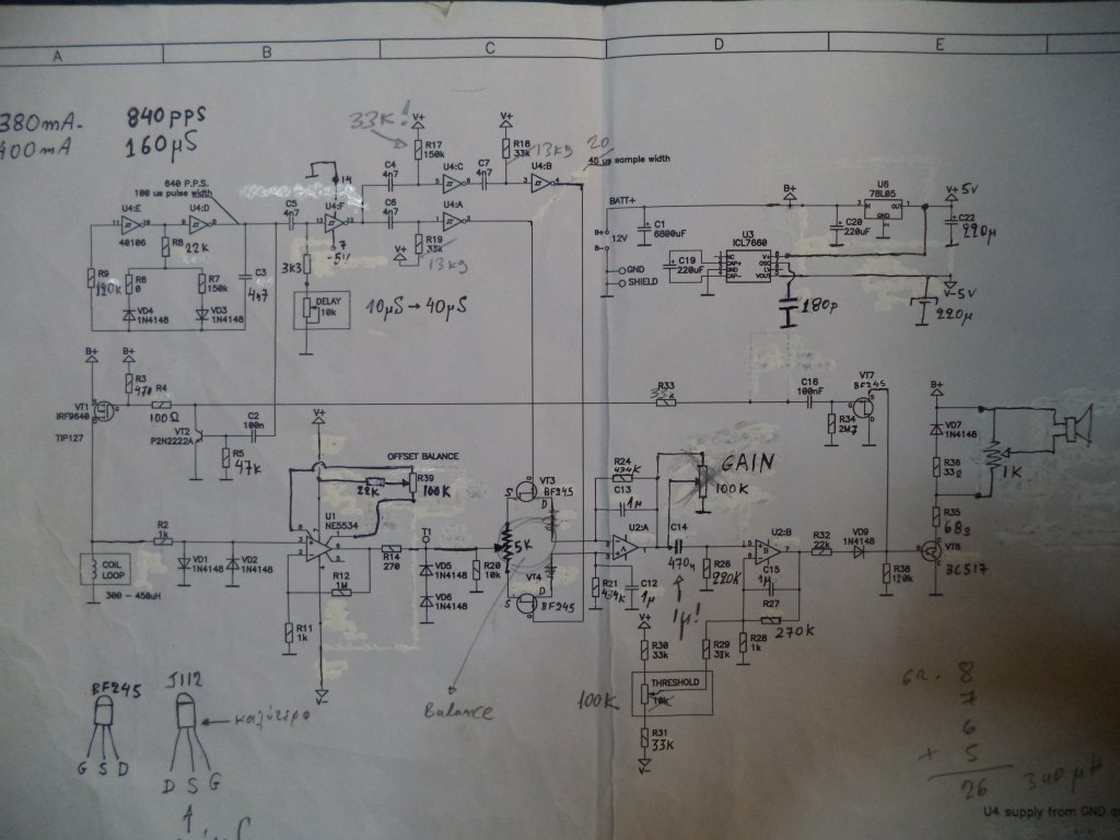

    Hi all I have a question. I understand that the Surf PI PCB can be upgraded to make the detector even more sensitive to targets and I am just wondering if the Baracuda PCB can also be made more sensitive to targets as well. I have been reading through the forums here but I cant find a list of what would need to be changed on the PCB any guidance greatly appreciated! Also as an additional question if an upgrade is available does it really make that much improvement?

    Have you seen this thread? -> Geotech Baracuda - REV-A - Project Details
      you must study double field coil subject and backet type coil subject. also do not
      do big coil. coil must be 16cm diameter or less. also we must do two stage preamplifier for bara to go to 5us minimal first delay.
      http://www.geotech1.com/forums/showt...o-stage-preamp

            Comprehensive!
              did i wrote These tags? i dont Thing i´m too lazy for such text
              but i can say ist only baracuda, crappy tuned
                Sorry about the quality
