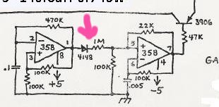

                          Homefire, if you don't like the modulated sound in your XL500 I think you can remove the 1N4148 diode or the 1MΩ resistor (or both) between the LM358 sections, and have an unmodulated target tone instead of the stock modulated signal.
                          I've seen two different "XL500", schematics, so this is depending on whether or not what I have here represents your unit.
                          I don't fully understand the audio circuit, and I'm sure there are some minor mistakes in the schematic, and possibly some other errors that I haven't identified that are hanging me up - so this is all I can offer for now.
                          I've got a big smelly fish to fry, so bye for now.
                          • #58
                            Thank you porkluvr ( big hug for you )I have removed 1N4148 diode and the 1MΩ resistor and you are absolutley spot on ...I have now mono tone "perfect"definitely more clearer with faint signals(i am excited).Here some results ....(xl 500 battery fully charged) using 12.5 factory coil...

                                I think you could remove the .1 capacitor from section A of the 358 to disable that unused oscillator. Definately leave the 100k to ground intact.
                                If you can make simple PCB you could maybe build a VCO on an outboard and wire it in. But putting it on the existing real estate - I just don't know about that. Then, there's the veroboard option. That could be quick and easy. BUT, no scope, no hope. (Hey, I made a rhyme.) (Sorry)
