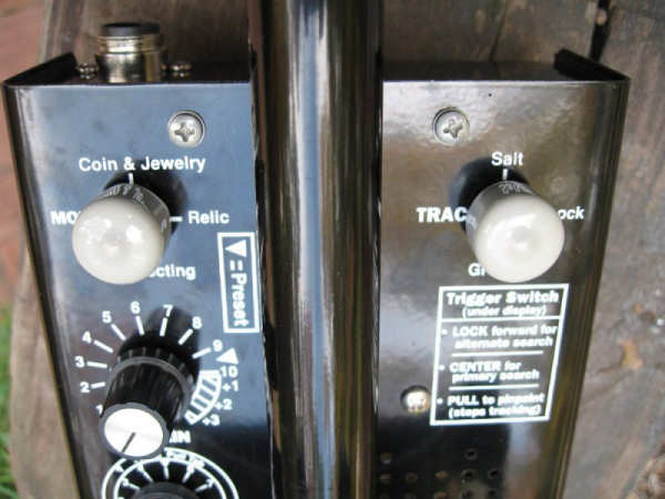

      I have seen some pics of a MXT with the two switches moved to the LCD pod and with two unknown knobs where they used to be.
      Wonder what that mod was and who made it. Ill attach the pics for You to make up an opinion.
      regards.
      Bjorn
        I remember this one, those aren't knobs. He just moved the two switches, those are just covers over the holes. Rob
          Thanks..
          I didnt even consider they were just covers for the holes. They are shaped like knobs arent they. Looks very 3 dimentional in the pic..
          There isnt many mods on the MXT around.
          Considering the huge number of sold units, modders must think they are very close to perfect as they are...
            MXT Knb Mods.

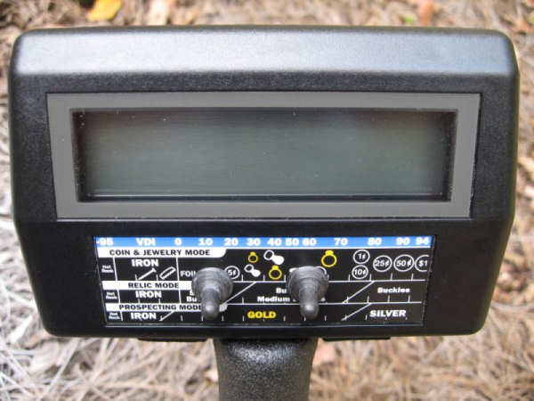

            I'm the guy that did the mods to the switches. This is an older version of the mod that had two switches added up on the meter where they should be in the first place. The two gray knob looking things were just covers to keep the original knobs from getting bumped. They have now been totally removed.
