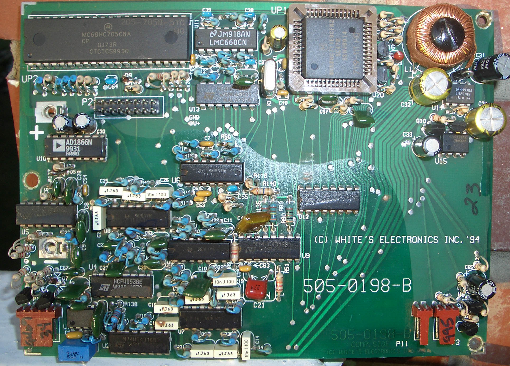

    Hello all,
    I'm new here, thanks for taking the time to read this. I'm a programmer with lots of interest in hardware, but only took a few digital logic classes in college.
    Since my Quick Draw's LCD has such a simple interface, I thought I might be able to pull the depth integer (1-6) off the LCD pins, and material (1-9). My plan is to solder a 6" pigtail to each of the LCD's contacts (they're long) and buy a rs-232 or USB controller. Then send that data out to my PC to put in a database. (along with a GPS waypoint - I've already established communication with my GPS)
    The problem is the LCD has no label, so I can't get a datasheet on it. I'm assuming Bounty Hunter wouldn't be in a hurry to send me one.
    I googled every chip on the board, and there's no external controller. So I'm thinking it's serially controlled, and that the big Zilog chip that drives the whole detector is connecting to the LCD serially.
    The bad news is, this isn't as simple as pulling a 5-volt spike off one of the pins, and sending it to an external USB/RS-232.
    So my questions are:
    -If this is serial, is there a standardized comm spec for serial LCD's?
    -If it's serial, and I had help mapping the pinout, could I simply wire my pigtails to an RS-232 plug and code a listener on my PC to parse the data?
    -Might the LCD only be taking an integer for those arrows (and not drawing pixel-by-pixel)? I'm thinking this because the startup only draws arrows, and doesn't turn the whole screen black.
    Many thanks for any opinions you might have. Below are a couple images, hopefully some of you have dealt with LCDs and might have advice....

            this is XLT board. I think if we re-place chip on modern Atmel we must get new advanced project.
              Motorola MC68HC705C8A tough chip.....
              Okay, on the Whites XLt board, it has a Motorola microprocessor, which is a MC68HC705C8A series 705 chip. In it, one can build his own chip reader unit, and read that part of the program inside that is not secured, it is so many lines. If the entire part is secured, that is all you will read. If it is not secured, you can read the entire chip inside. There was a guy in Michigan, who built his own software, before the FBI raided him, and he used to read those particular chips. I belive I have a data sheet on this chip.
              Now on the other detector, with the Zilog chip, again same way. Some of those are not secured, some are secured. Those are microprocessor chips, and they use them also in cable TV boxes.
                You can build a logger unit.....

                Well, since you are involved in electronics, you can build a logger circuit and you can read the output pin, coming out of the microprocessor unit, it will not tell you the software inside the chip, which is usually secured, but it can tell you the data it send out. I have a logger circuit for Windows that will log the data of cable boxes, and it may possibly work on that unit, one never knows for sure, it is set up for selectable baud rates and baud settings. It is how they cracked the analog Cable TV cable boxes, read the FM commands coming through the cable TV boxes, then figured out what each line of command meant. Each line of command had a beginning byte, which indicated how many bytes were in that line of command, the first number after that number of bytes in the command was, the number of that command. The last byte in the command, was a line checksum byte. By checking the total line of bytes, you can figure out the beginning of the line of command, and of course, the line checksum byte is the last bytes in the command line. I am speaking of cable TV boxes of course, not metal detector MCU units....

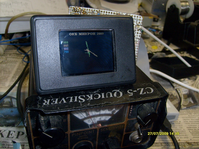

                          colour godo [VDI] for CZ-5
                          is it a good example for your future advanced project vision?
