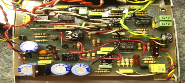

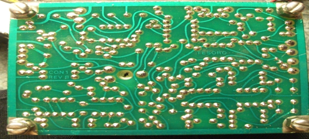

            Post me a photo of the PCB on here and I'll arror up the Diode in question for you (top AND bottom of PCB please).
            I dont have a SS to look at so this is why I ask.

              Hi Sean
              Thanks for the quick response, here are the pics you wanted.
              Cheers
              Stan

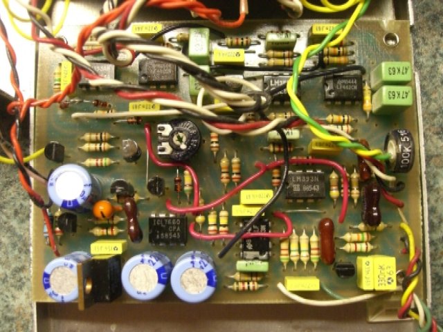

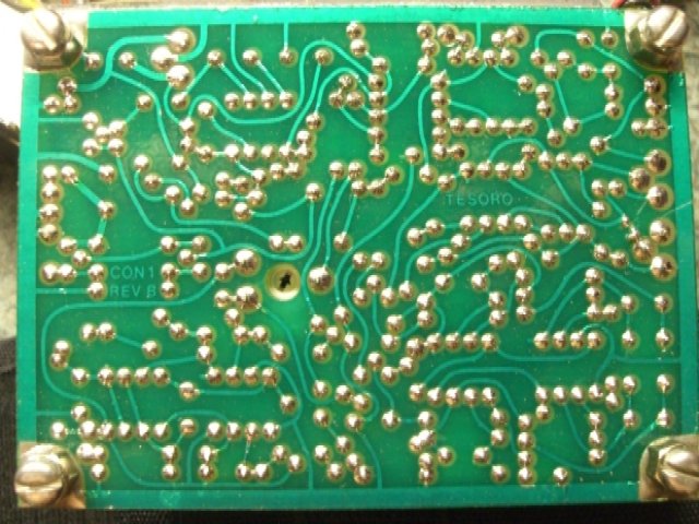

                Hi Stanley,
                Hope you don't mind. I've resized your photos to the correct aspect ratio.
                  photo changes
                  That looks more like it
                  cheers
                  stan

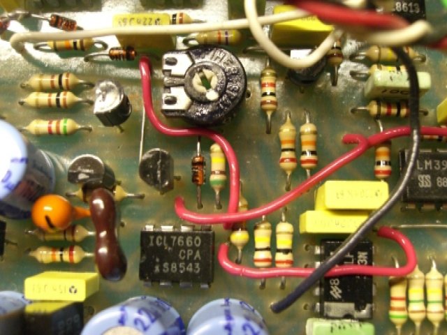

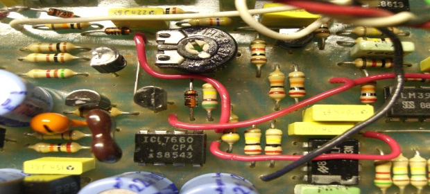

                    Third close up is wrong area entirely for this mod BTW. Off hand I think it is the red wire near the Transmit transistor.
                    I'll be REAL quick about this as I have to go to a meeting.
                    Locate the TX transistor, simply look for the correct values connected around it. Follow the RED and Yellow wires frm the SH connector. Then look at the emitter, you can find the pinout be Googling the transistor type AND TO-92. From this there is a RED WIRE, cut this and solder a NEW length FROM the transistor end pad to the point where the battery POSITIVE enters the PCB (This is AFTER the On/ OFF switch). BINGO more Tx power, but ONLY on new betteries.
                    If you use Rechargeables you will get moe power and depth for longer. I have ot say though, that on SOME machines this mod WILL make the machine chatter uncontrolably. Best done WITH the sensitivity mod too, this will make a SS as good as the Vaquero without the stupid extra cost.
                    Hope this helps.

                        the reason i put photo number 3 ( shot of diodes)is that in your text for mod part 1 it says for the sensitivity mod replace the 1k with 8k2 with other end connected not to ground but to the cathode of the diode nearby (-5vo).
                        this is why i included photo number 3 .There ary only 4 diodes on the board and all are in shot .Any chance you can mark up photo with the correct point (ONLY WHEN YOU TIME DONT YOURSELF A HEADACHE OVER IT)
