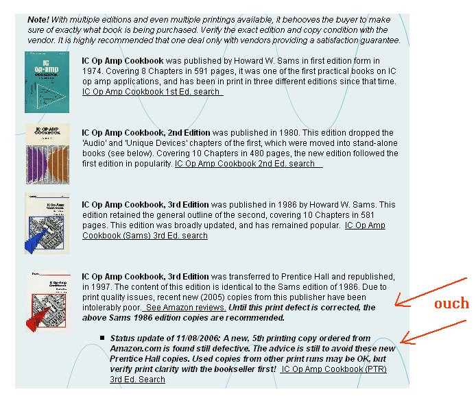

                        HOWEVER
                        Walt recommends not purchasing a recent printing of his book "IC Op-Amp-Cookbook" because of poor print quality.
                        Jung used to be an IC designer for Analog Devices.
                        Check this out:
                        http://waltjung.org/index.html
                        There are links to search for his books and also some very interesting free application notes.
                        I only just today found Jung's website. Lots of good stuff.
