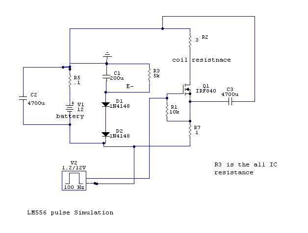

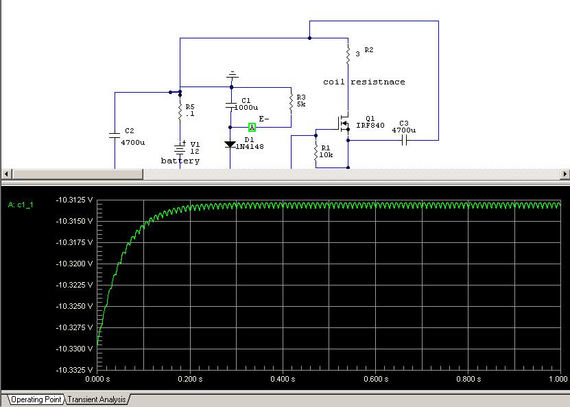

      hi every body
      i make some circuit maker simulation on delta pulse in power supply section
      see the photos
      there is some noise in E-
      R5 here is the battery internal resistance
      assume good battery
      test done on 100hz
      c2 and c1 and c3 affect on noise level
      but more value of C1 will give more time for voltage E- to rise up to -10.6
      and the LM556 will have to voltage s
      E+ and E+ so the output will be high and this will destroy the mosfet

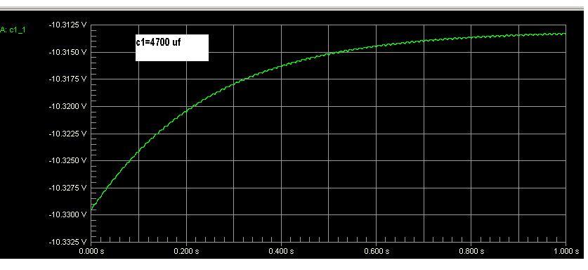

      see if change C1 TO 4700 U
      • #48
        test with higher value

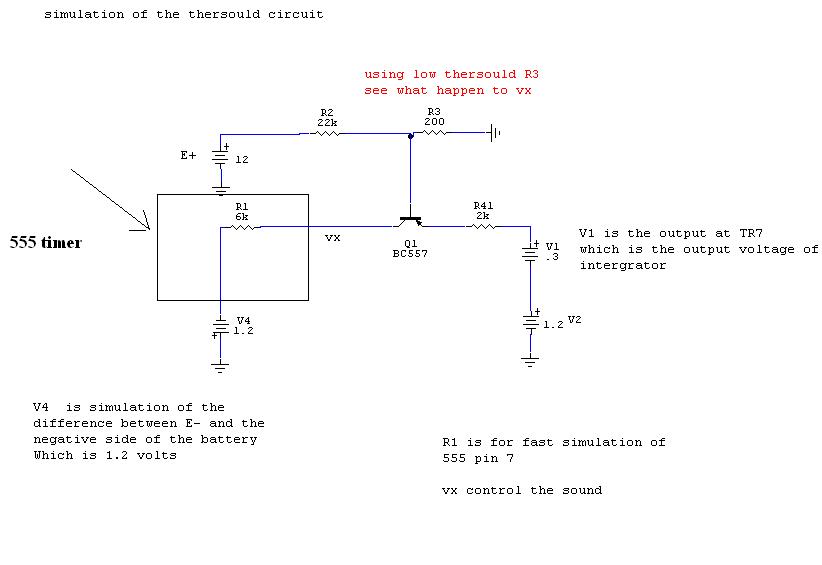

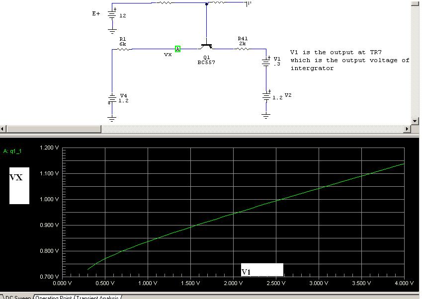

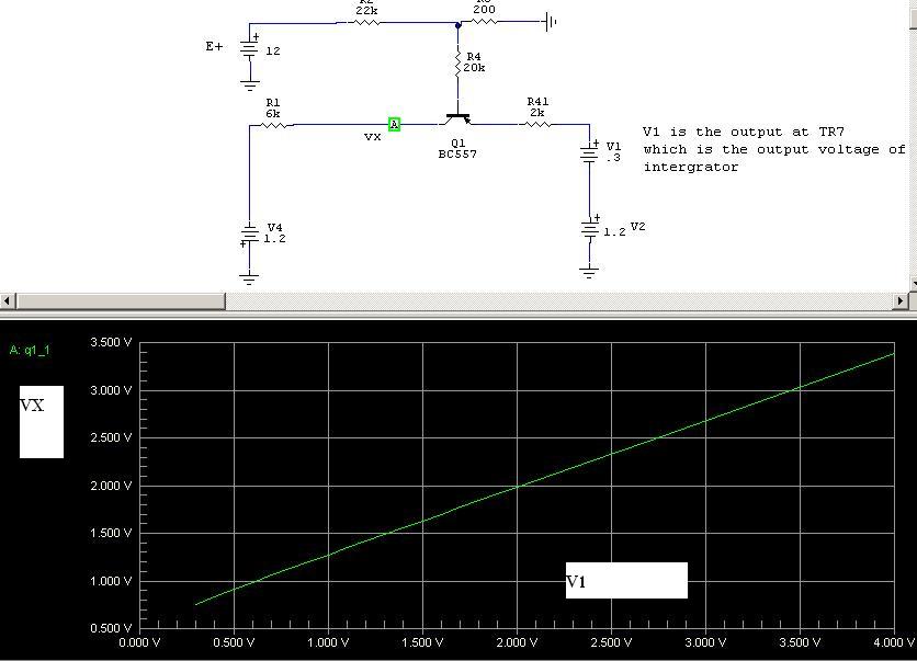

                • #53
                  Originally posted by pigeon View Post
                  20K or 2K
                  see the photo
                  • #54
                    see th effect of insert 20 k or 50 k
                    in vx which is pin7 of 555 timer VCO
                    when threshold in the lower setting (R3)
                    you didnot get the full voltage from V1( tr7)
                    *- R depend on meter for me i use 50k so i get full reading at low threshold
