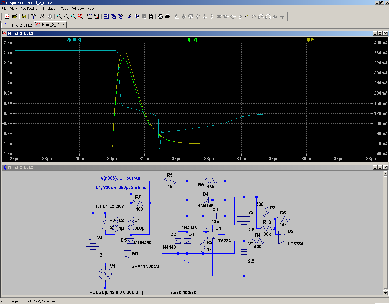

            Some thoughts, maybe correct maybe not. With the two stage amp the bandwidth might be high enough that the input resistor acts as a damping resistor. The damping resistor and input resistor are in parallel giving you a damping resistance closer to 600 ohms. I doesn't matter in the circuit just the thinking on how it works. The circuit I've been playing with uses the input resistor only, allowing a lower value input resistor (less resistor noise).

              I have a working spare CHANCE PI board equipped with the 390 ohm resistor and when I ohm it it reads 390 ohms to board ground. So I cut the resistor out and ohmed it again and got 440 megohms using the ohmmeter leads in both polarities on all my measurements. I don't think I am seeing the Rcv amp input 1k resistor across the coil at all. I believe the OP37 is a FET input op amp so there is a lot of input resistance. Probably what is happening is the negative going diode of the back to back 1N4148 pair is conducting down to .7 volt during decay damping and then shutting off below that voltage. Does your scope trace show diode cutoff at 0.7 volt during damping?

                I think the circuit is similar to yours except N channel instead of P channel, so the voltages and feedback diode are reversed. I made R damp a little higher resistance than R input so the currents aren't the same. If R input went to the + input the current would stop when coil volts dropped below .7 volts. The output of the op amp tries to keep the + and - inputs equal with feedback. When the output can supply enough current, the - input will go to zero since the + input is at zero and the output will go to .7 volts due to the diode across the amp. The R input continues to draw current so the R damp and R input are in parallel. The spice circuit works if you remove R damp and change R input to a value equal to the parallel resistance. I've been using two 500 ohm 1/4 watt resistors in series for R input with no R damp for bench testing. My fet clamps at 450 volts instead of 200 volts. The on time effects the heating but I haven't burned any up yet.

                        If the circuit critical damps with 1000 ohms and R damp and R input are in parallel I could make each 2000 ohms or make R input 1000 ohms with no R damp. Lower input resistor less resistor noise. Makes sense to me but I'm no expert so maybe it doesn't matter. Maybe it would be better to use the two 2k resistors. Maybe someone that knows could explain which is better. I think the main thing is R damp and R input are in parallel when connecting to the inverting input. Using the inverting input does shorten the delay time to sample. Don't know if there are any disadvantages.
