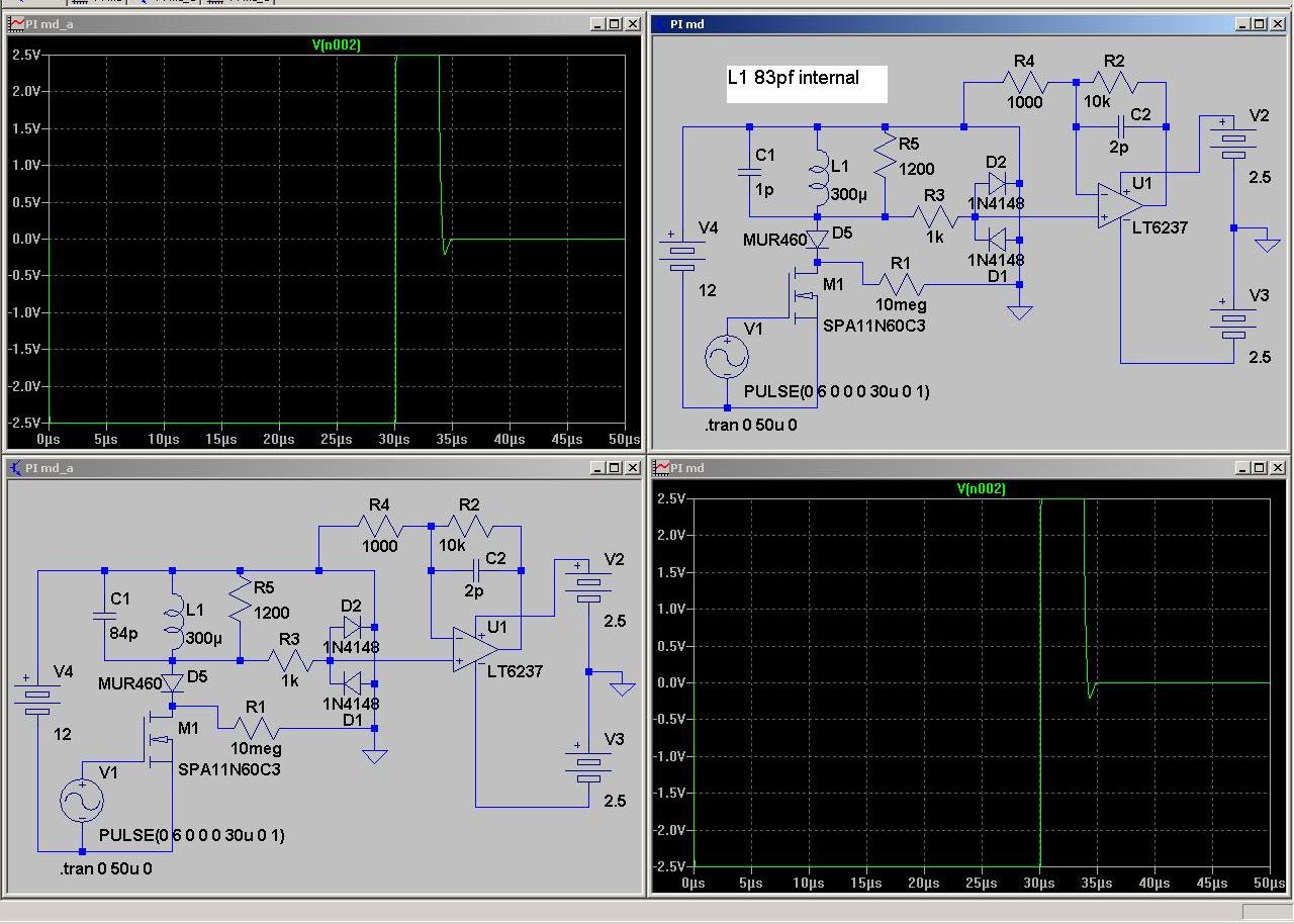

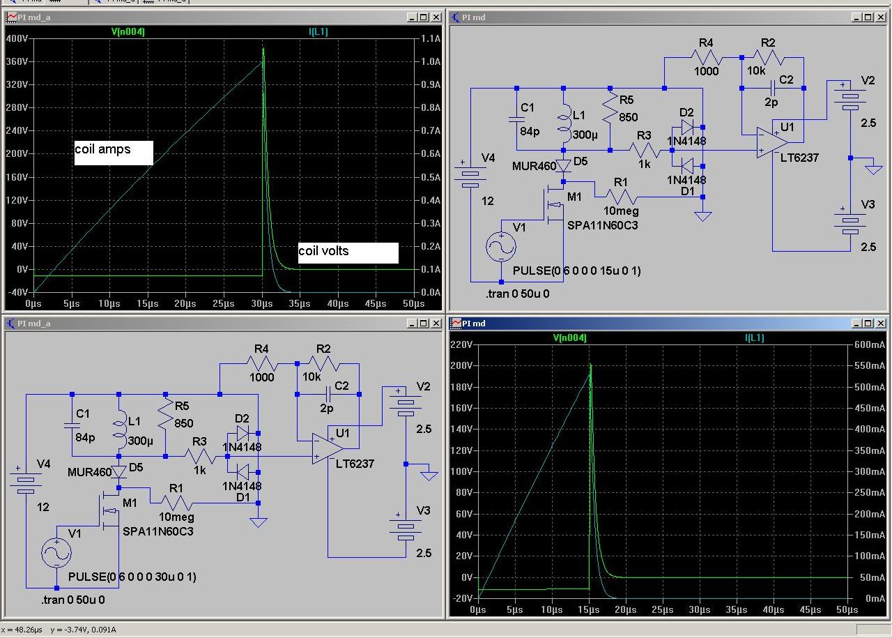

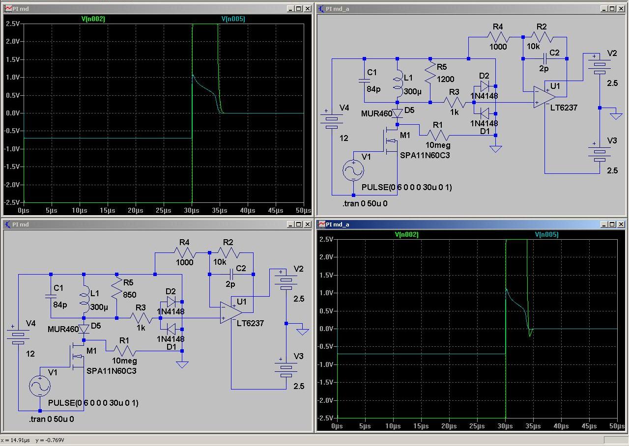

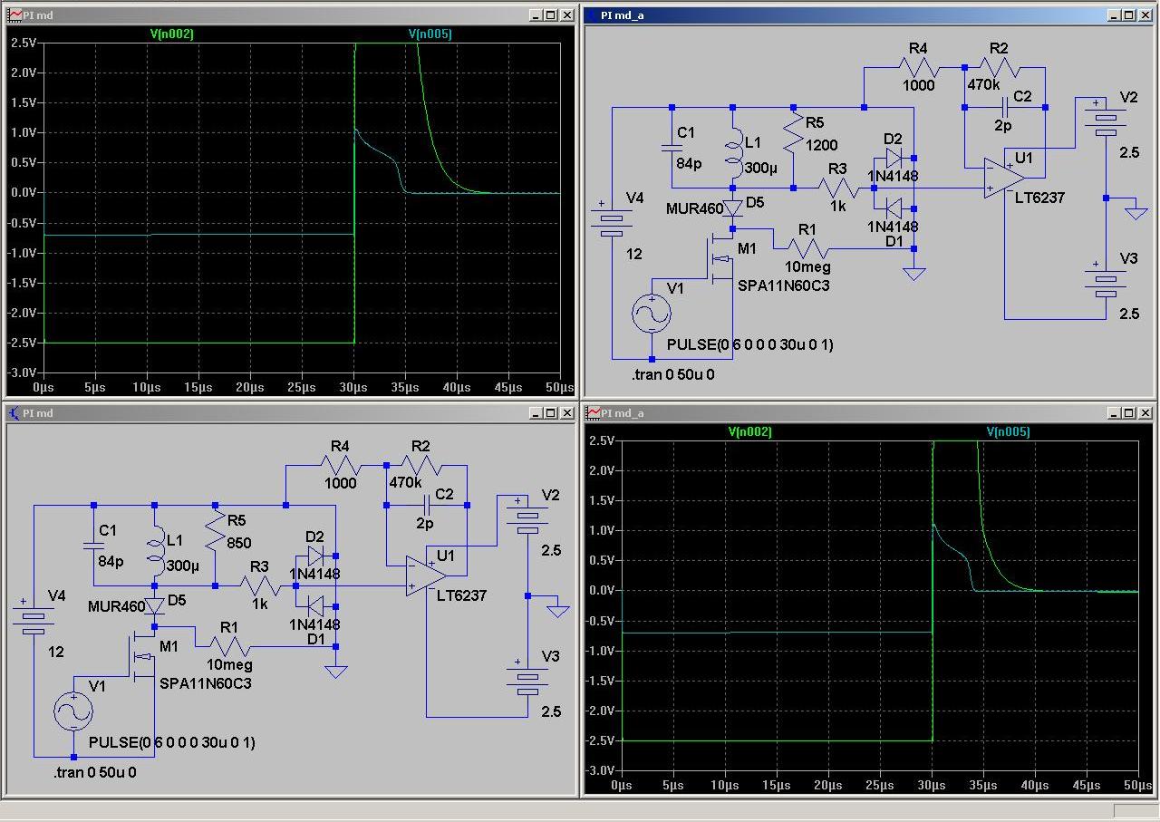

                        Including a spice simulation at two current levels. The decay looks the same, trying to understand why Rd needs to be adjusted.

                            The LTSpice simulations are an excellent working tool. However, There are so many variables in our PI circuits and each variable influences the results. I hope in time to have models with accounting for all the variables, but it may take a long time.
                            The MiscEl app is not updated for the latest Windows, so it starts with a lot of error messages that you have to click on, but then it works just fine. It is an excellent tool.
                            Below is a LTSpice file, zipped. It only uploads when zipped. This way we can use each others simulations without having to redraw the whole circuit.
