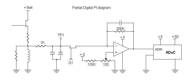

    I am going to start designing a digital PI board. This is a partial diagram showing the area I am concerned about now.
    Starting at the back end and working toward the front, the ADuC microconverter runs from a single 5V supply. The analog input range is 0 to 2.5 volts, but the input can go up to 5V without damage. With this narrow input range I do not see any point in having a wide output swing from the amplifier. I would just have to clamp the voltage to the allowed AD input range anyway. So I would prefer an amplifier that runs off a single 5V supply and which allows the input voltage to go below the negative supply rail. With this amplifier configuration it makes sense to connect one side of the coil to ground.
    During the coil on-time the coil voltage will be positive and may go as high as the + battery voltage. During the flyback time the coil voltage will go below ground by a couple hundred volts. During the off-time the signal will be below ground but should be within a few hundred micro volts of ground.
    At TP1 the signal is clamped to within +/- one diode drop of ground. So during the coil on-time the voltage will be +1 diode drop. During the flyback it will be -1 diode drop. And during the off-time will be within a few hundred micro volts of 0.
    I am looking for an amplifier with the following characteristics:
    - single 5V supply
    - allows inputs below - supply
    - can provide single stage gain of 300
    - has gain bandwidth product greater than 6 MHz
    - has reasonably low noise
    I am looking at the AD8031 for the amplifier. These are the things I am worried about:
    1. During flyback TP1 goes below 0. The output of the amplifier can only go up to 5 volts. So the -input of the amplifier may go below -0.5 volts. This is the limit of the AD8031 linear range. I do not know what the amplifier will do in that case or how well it will recover.
    2. The gain is high enough that the input offset current will be a problem and the amplifier does not have an offset adjustment. This means an offset adjustment should be added to the amplifier input.
    3. The AD8031 noise figure is not as low as I would like. It is about 4 times higher than the 5534. But the amplifier noise will still be way below the external noise.
    4. During the off-time the target signal will be negative but noise can make TP1 go positive. This will cause the amplifier output to hit 0 and cause a bias in the AD samples. It would make sense to bias the amplifier +input a bit above ground, but this makes point 1 worse. Maybe if I bias it only a mV or so this will take care of this point and point 2.
    I would appreciate any suggestions.

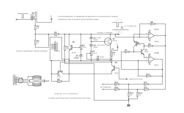

    i solved this problem using active blanking and some extra fet s a switches
    simply removing the diodes out the equassion
    so now you get a nice voltage swing you can set a max amout too with a pot
    here is a jpeg to show this stage and its switches

        I have thought about gating the signal, and that is something I will still consider. One consideration though is that I want to keep the parts count low. I would like one version of this to fit inside an electronic probe on a board about 20 mm x 80 mm or about 0.8 x 3 inches.

            Update
            I have modified the design a little.
            I added an offset adjustment for the amplifier that will allow the amplifier output to be set a couple hundred millivolts above ground. That should provide room for offset and noise and drift.
            I also added a FET so the amplifier can be disconnected during the coil on-time and flyback. There are two reasons I would like to do that. One is to protect the amplifier input from going too far below the negative supply during the flyback. The other reason is that I would like to be able to reduce the amplifier bandwidth for long time constant targets. I have not shown how that would be done yet. This would be for use with long sample delays where the short time constant signals are not going to be detected anyway. The narrower bandwidth would reduce noise. The problem with less bandwidth is that the amplifier would not recover from the flyback pulse in time. The gate keeps the flyback pulse out of the amplifier so it does not need time to recover.
            The timing sequence for short sample delays would be: turn coil drive off, wait a few usec for the field to collapse, turn the wide band amplifier on, wait for it to settle, take first sample. The timing sequence for long sample delays would be the same until the amplifier settles, then the amplifier would be switched to narrow band and after a longer delay the first sample would be taken. By wide band and narrow band I mean roughly 20 kHz and 5 kHz.
            I need to find a low current FET that will be off when the gate is 1V above the source and on when the gate is 4 volts above the source.
            Robert
              Re: Partial digital PI design
              hi robert
              take a look at this little bmp
              then you can tune some more bits and dispense with the shunt recifier leaving the signal path clear
              but also gate the even to a second fet follower type amplifier
              i used a buk device {made for pwm}
              also a simple npn switch for the voltage peek
              {after the shunt resistors on the coil the voltage wont be much
              as a 1n4148 is only 50 v piv so.....
              a transisotor alone is fine
              to shunt away and ht
              and also give resample gateing
                              I tend to prefer designs that use only enough parts to get the job done.
                              I used two clamp diodes to provide protection for the op-amp. There might be more complicated ways to accomplish the same thing, but this simple method seem to work adequately in other designs.
                              The purpose of the FET is to keep the on-time and flyback pulses out of the amplifier so I can play around with narrow bandwidth. Either a series or shunt FET could be used. There are some potential problems with the design I showed. I am trying to get by with only a +5 volt supply. This means that I only have a 5 volt logic swing available to switch the FET. I need a minimum Vgs that is greater than one diode drop and a maximum Vgs of about 4V. Also during the on-time the source will be about a diode drop higher than the drain. The FET has to remain off when this happens, so it cannot have a built in clamp diode. But what is worrying me the most is the possibility of noise getting into the input of the amplifier. The output pins from the CPU have low level noise on them. I am afraid that some of this noise may get through the FET and into the amplifier. Since I want to achieve a sensitivity around one microvolt it would not take much noise to cause trouble. So I am thinking about removing the FET. Instead I would put a switchable filter after the amplifier. The signal is larger there and will not be as sensitive to noise. In that case the amplifier bandwidth would stay the same but there would be a 30 usec RC filter between the amp and the AD that can be switched out.
